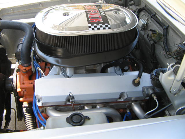

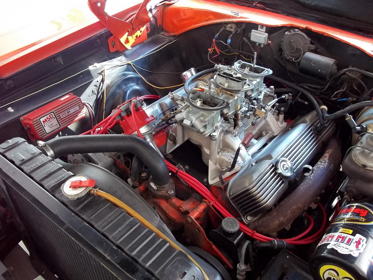

Here's a pic of mine last year. Sounds like about the same setup except for the heads. Ran great then and runs great now even after changing to exhaust manifolds from headers.

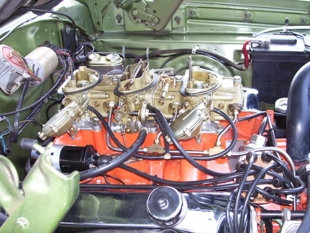

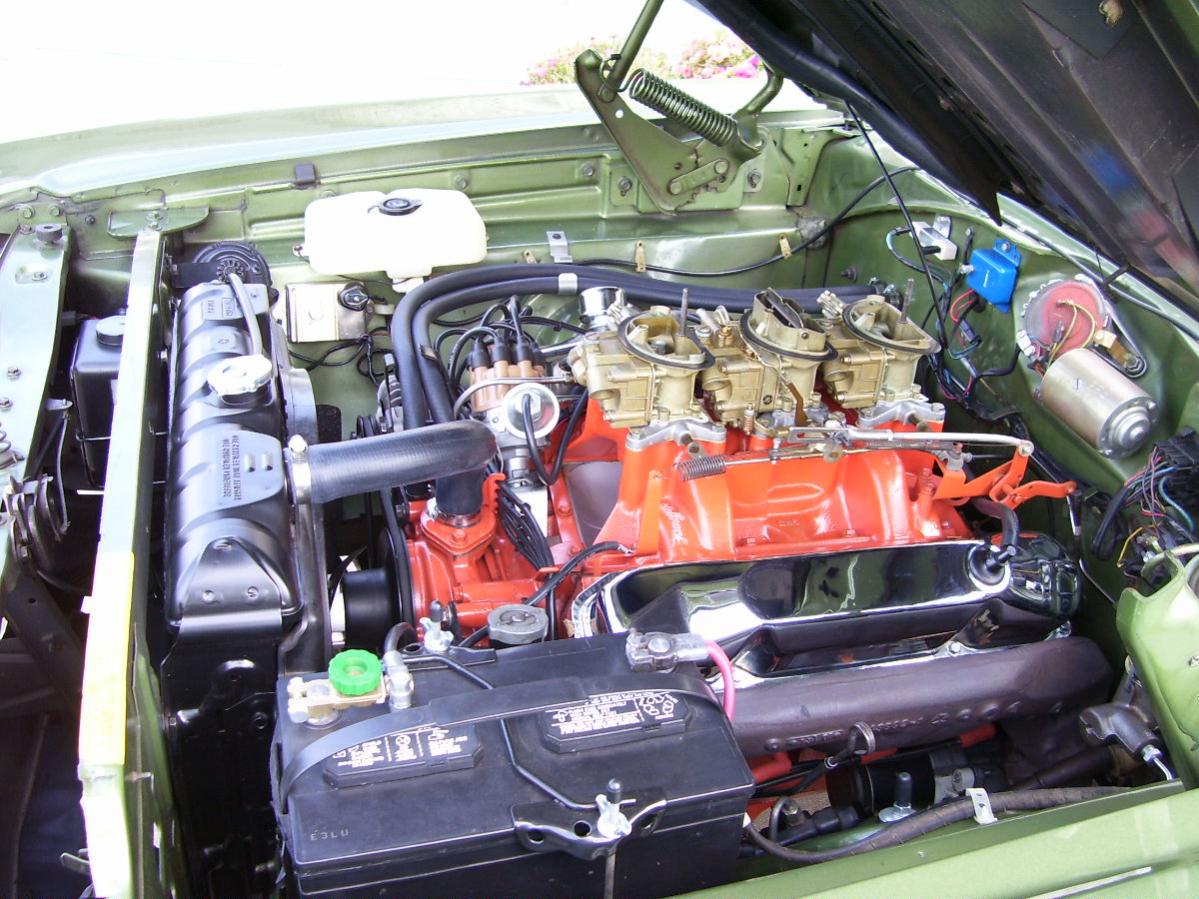

I own a 69 Superbee 440 6 Pack that has been reworked by the previous owner(s). I was wondering if your is correctly set up do you have some pictures from different angels without the air cleaner on so I can try and put my back the way it belongs? Thanks alot.
these might help. stock configuration of carbs.
