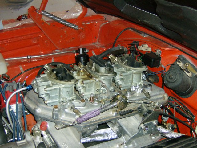

This has been on my car for about 5 years no problems.Talk to Ben at promax 317-484-1451.I have their metering and jet kits on my carbs.The kit makes it easy to tune your carbs.What was said about power valve is true. Everyone said this intake wouldn't work on the street.No problems idles at about 8-900 rpm

You're right on the vaccum.I have a electric vaccum pump under my fender.
GTX- How is the hood clearance? As far as vacuum goes, I don't have power brakes, but would the poor vacuum efffect the outboard carbs?
For my intake you will need a scoop.I don't think it takes much vaccum for them.Full race strip only cars run them.But i am running a cowl hood.I did have a six pak hood on it.

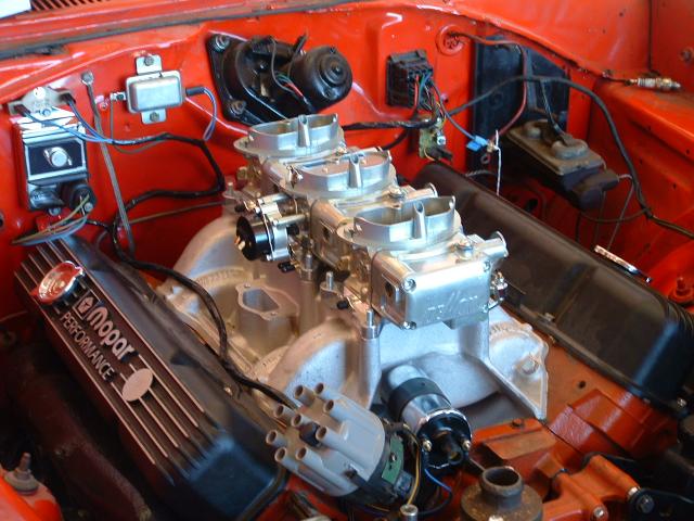

The problem with running the Weiand tunnel is fuel distribution. It's really the concern with all intake and carb setups because the fuel is discharged in the plenum area far away from the valves and has to make its way to the runners in equal proportions. It's called wet flow.
If you make a WOT pass with the Weiand you will find some cylinders will be rich and some will be lean. You must check every plug to determine exactly what to do. Also, jetting is not the final answer when tuning a carb. The size of the high speed bleeds affect the mixture at different RPM ranges and adds another dimension of tuning. I believe a larger high speed bleed orifice will lean the mixture at high RPM but not affect the low and mid range so much. Opposite is true with a smaller orifice size.

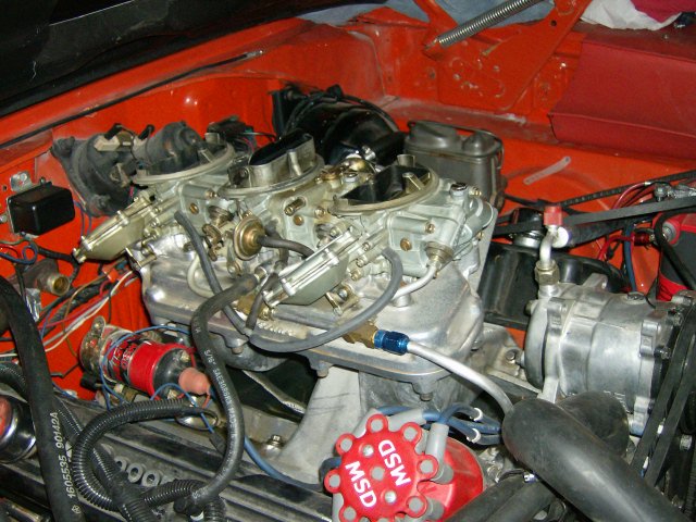

here is my barry grant set up on my charger , I may need to get that lokar throttle bracket and cable .
I had to fab mine and its really rigged up , I love the electronic choke. Very streetable.

What kind of AC compressor is that?
OOooooo! I LIKE Demon carbs! Based on Holleys, but with tooling thats 50 years newer! For around the same price too! [tongue-in-cheek slam at Holley]. That set-up looks awesome Stuart! This whole tread has me rethinking things......
