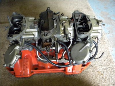

I have a six pack and the only carb that is adjustable is the center carb?? I have seen several and none had outboard carbs that were adjustable.
This is my six pack as you can see the outboard carbs don't even have the metering DSCN8054.jpg block
the idle mixture screws on the end carbs will need to be out 3/4 turn as a starting point, the linkage that ties the end carbs to the center carb must not be tight; should be a little wiggle. you don't want the throttle blades on the end carbs cracked open; that will really screw the idle up. check the idle feed restrictions in the end carb metering plates to make sure they're not plugged. opening them up to .038" wouldn't hurt nothing. i don't think you have enough timing at 800rpm. i'd shoot for at least 16; 18 would be better. if it's an automatic check the idle vacuum in gear. i think you need a 4.5 power valve. float levels in the end carbs should be a slight trickle out, or at least up to the sight hole. primary carb jetting will need to be at 64, maybe 65. don't go out and blow a bunch of money on gadgets, and don't try to re-engineer the carbs.
