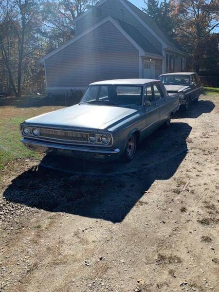

I've been working on my newest toy that I bought last year. The last real issue I'm having is the 1 barrel carb. It's a 65 Dodge and pretty much original. I got it to a point where it's running pretty good. I leave it to a good friend to really fine tune it. He knows his stuff, really old-school. Any way, it's been at his shop and we order a new rebuilt carb (a couple of issues there but it's been resolved) Anyway the /6 runs great but when the choke fully disengages when it's warmed up the car starts to idle rough. Now he put in a new pcv valve, made sure that's not an issue, distributor is electronic so no points. When he puts his hand over the throat, it idles smooth again. He's tried everywhere to find a vacuum leak and no go. Now he's thinking that maybe the valves are adjusted too tight. They don't make a sound and purr like a kitten. The valves seem to be the last thing to try.
Anyone have any other ideas or does the valves sound like the issue?
