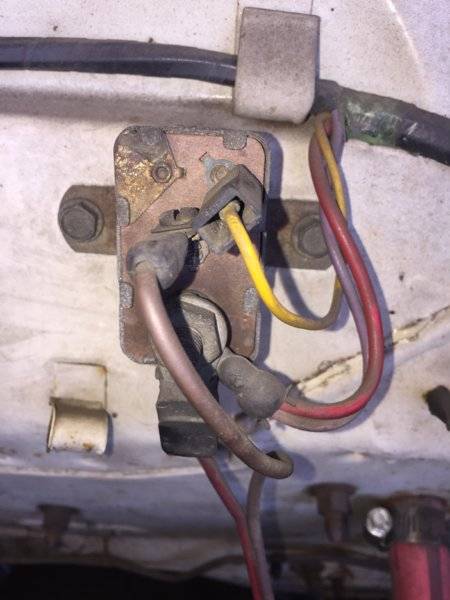

        After checking all the plugs (NGK R-4), gapping them at .037, removing the plug washers, put everything back together and.......
        Now I got bigger problems!
        Turn the key to start......nothing happens, no starter, no click.
        IMG_1366.JPG Checked all pertinent wires, all seem good (battery is brand new and I have power to everything else).
        So i jumped the solenoid and started it, am thinking the culprit could be the starter relay, any advice is always appreciated. Thanks.

        Yep,my 68 was hit or miss, finally changed the relay.There are 2 different ones.One for stick and one for automatic. You have been thinking about putting a automatic in it so you may want to buy one for the automatic. It has a extra spade terminal for the neutral safety wire that will hook to the switch on the tranny.
