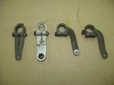

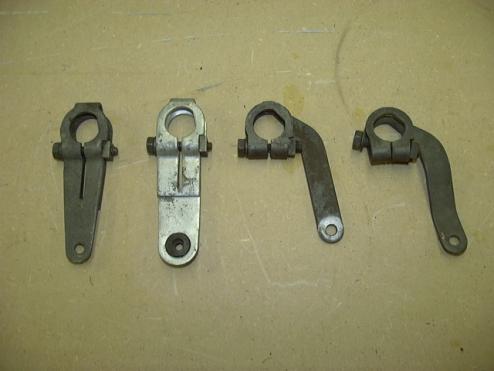

Would anyone know the proper shifter lever for a 73 Charger 340 with a slapstick . I thought I knew which one to look for but now I am not quite sure. I found a picture showing one straight and one dog leg...which one is correct.
Thanks
AL

LOL... that is the one I thought was right as well..until I read a post from a guys saying that the adjustment rod was not long enough to reach all the shift points.. grrrr I guess I will have to find and buy both...LOL
AL
Thanks Tom that is just what I needed to see, so the straight one it is...now who's got one LOL.
AL

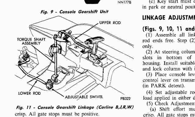

This is the lever that was on one of my 72’ floor shift cars, not the original 727 and never got to drive it so not sure if all the detents lined up with the gear selector positions. Based on the service manual diagram, I’ll be starting out with it. The column shift 727 and 904 equipped cars I have had the straight lever.
LOL.. This is where is gets confusing, because that is the one my book shows as well. The one on it now is dog legged but very short arm so I am sure it was from a after market shifter. Who knows maybe both the straight and the angled ones work.
Back to thinking I should get both LOL
AL
