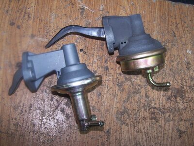

All mechanical fuel pumps have a 1/8" hole in the side of the housing and that hole is there to release fuel to the outside rather the pump fuel into the engine in the case of a diaphragm failure. If your diaphragm failed and is pumping gas into the engine oil, you should see a higher level on your dip stick when you read it.
Actually that hole is to vent the top side of the pump diaphram. If not and the top was sealed it would cause some pressure and vacuum to build on the topside of the diaphram. Course if the diaphram sprung a small leak much of the fuel can go out the hole but the diaphram may push more fuel right into the crankcase then out the small hole if its pumping enough to keep the eng running. I would think the bigger opening at the pump arm to the crankcase would put more fuel that way then out the hole which is much smaller. Ron

I may have mis-spoken when I said all mechanical fuel pumps have the 1/8" vent hole. I checked a couple of Fuel pumps I have on hand. Both are AC branded. The small block pump has two 1/8" weep holes in the upper housing and the big block pump has a rectangular hole but the only purpose of those holes is to allow fuel to escape if and when the diaphragm develops a leak. These holes serve two purposes. They are located below the opening to the lever leading to the engine to help insure no fuel enters the engine oil also they act to alert someone that the pump is failing before a complete failure. Not all fuel pumps are created equal and maybe some brands don't even have this feature but Carter and AC do for sure. Here is a pic of what they look like.

I think your pump is leaking fuel into the engine, probably a leak in the diaphragm.
Your spark plugs are burning too cleanly for a rich condition caused by the carb to cause a fuel smell from the crankcase. To get that amount of smell would need a significant amount of fuel to be getting into the engine, such as being pumped in..
