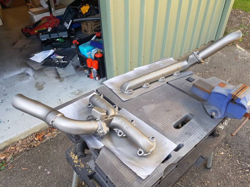

The heat control valve is where I need a kick up the *** anyway. It spins freely by hand from the outside, 360 degrees - I'm not sure it's even inside there. The thing that's annoying me is why I didn't check it properly when I had the manifold off. The nuts where the manifold flange connects to the down pipe were welded up at some point over the years so I'd cut the pipe off further down when I removed the engine and
couldn't see the valve from the inside l. I put some bent wire down there to check if the valve was open and it seemed there was no valve in there at all, but I'm not 100% sure, and it would have been 100 times easier to cut the manifold open to check and then weld back up while it was off the car, but I was keen to get the car running, so I painted the manifolds and put them back on...
To check it now will be a royal pain in the ***, but I will if we can't find anything else.

Well it's definitely not the manifold heat control valve. I pulled the manifold off and cut the damn thing open and there's no flap in there - just the rod.
