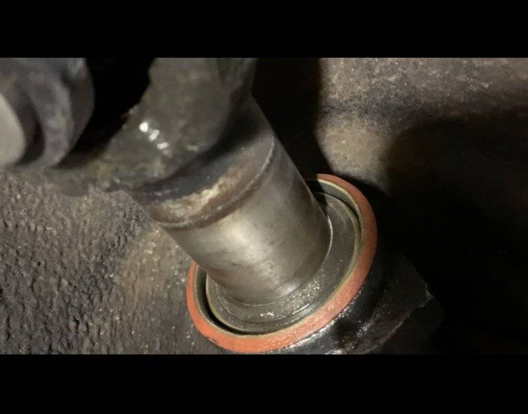

If your yoke rocks you have a problem. How about a picture of end of trans to front u-joint and if the weight is or isn't on rear suspension.
Here is a pic. This is at ride height with full weight on the suspension.

Mine looks the same with the shorty seal. On the left edge of picture is that the u-joint cup hanging out?
The u joint caps do hang out like that but they are installed correctly. These are the smallest, 7260 joints with the C clips on the inside of the yoke.
