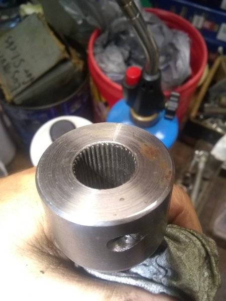

I am ok with getting a new steering box, but I was looking at the column and it sure seems like I have a lot of slop there. I remember NOT being impressed with the coupler when I got it. I will try to link a video.
PST sells a manual box, with a coupler its +$140. I'm ok with that if it fits better than the one I have. I just looked at my Ebay purchase and I paid $117 for the one I got.
What do you guys think

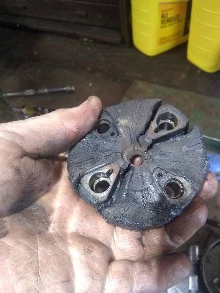

The 73 and later cars used a "rag joint" up near the firewall, right? Are the bolts there tight? What about the column plate on the inside at the firewall?
Column to firewall is tight. Rag joint bolts look tight, but looks like rubber has deteriorated.
I will pull it apart.

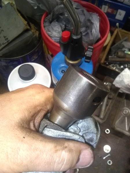

Here's another video, just the coupler this time. I know having the pin in tightens it up some, but to me this is unacceptable. I am going to try to check the hardness, the outside looks like plain cold rolled steel.
I bought this from Ehrenberg. I see he no longer has any items listed on eBay. Maybe he's retired.

Rag joint has had too. Was probably ok with power steering, but perhaps the extra torque with manual was too much for it.
That "rag joint" probably has a more proper term for it. GM used those for years. I has a few Chevrolets years ago and that was a place to check for steering slop.
Yours looks worn but I do see what looks like slop between the adapter and the steering box input shaft. I'm having a hard time seeing it clearly though.
I break balls a lot but I am serious about the vertical video. Steve Jobs should have been kicked in the balls for making the vertical aspect ratio the default setting for the iphone. It looks horrible for anything except space shuttle launches and skyscraper pictures. It makes every video look like you're a kid that is supposed to be in bed asleep but you're watching the tv through a narrow opening in the door. No computer, TV or movie screen uses this format.
Does that adapter feel loose with the steering column disconnected?....Just attached to the steering box, does it wobble?
Yes the last video is just the adapter disconnected from the column
The roll pin should tighten it up but again, it is hard for me to tell just by the pictures.
It does tighten it some, but then it wobbles.
Theoretically, the roll pin will only hold it in the axial direction.
I got the new 20:1 box from PST, along with a new adapter.

Made a replacement for the rag joint out of steel.
Got it all installed Saturday. The new box and adapter fit together nice and tight.
Tested on road and track. Steering is vastly improved.
