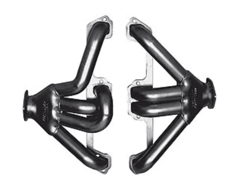

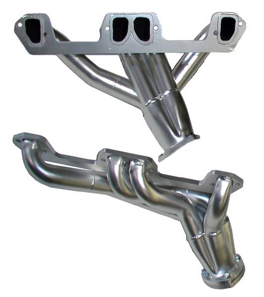

I like the TTI shorty headers for spark plug clearance. They seem to have a shape similar to the HP manifolds for small blocks. http://www.ttiexhaust.com/MoparClassics-Headers/34025-Shorty/TTi34025.htm

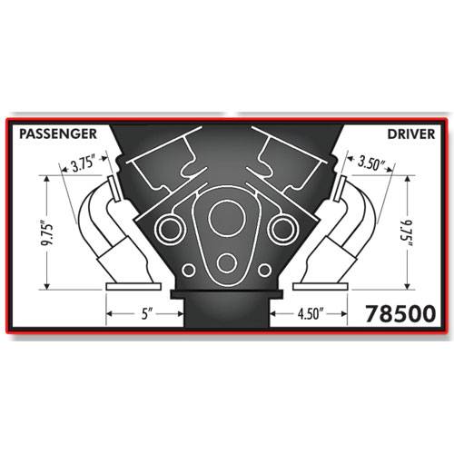

A cheaper option by half is the Hedman tight tube headers. Supposed to fit. https://www.jegs.com/i/Hedman/500/78500/10002/-1?ymm=4294829708+4294828902+4294828898

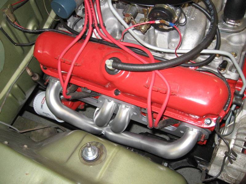

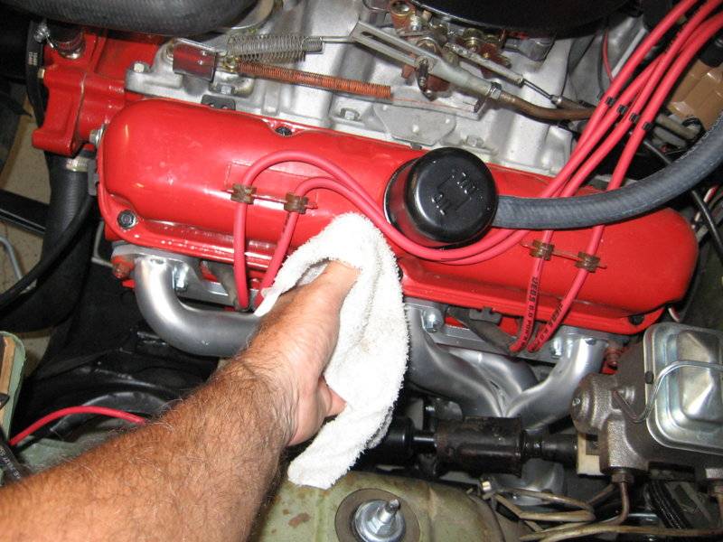

I've run the same TTI shortys pictured above on a 68 Valiant. Did a whole install sticky over on A Bodies.
Honestly the easiest header install I've ever done. No plug wire problems. Outstanding fit. The engine was a 273. The sound was way better than stock. I would believe you would be happy with them.Didn't even have to remove the spark plugs or wires during the install. No need for a oil filter angle adapter, mine had one so I reused it.
Honestly the easiest header install I've ever done. No plug wire problems. Outstanding fit. The engine was a 273. The sound was way better than stock. I would believe you would be happy with them.Didn't even have to remove the spark plugs or wires during the install. No need for a oil filter angle adapter, mine had one so I reused it. View attachment 852180 View attachment 852181
Thank you, for your feedback. Were you able to keep the original starter too and to you they are worth the extra money spent ?
Yes you can but I put a small one in.If you do go with TTI make life easy and get the down pipes with them. I installed the complete system to the rear bumper.They make 2 port sizes small for the 273/318 and large for the 340/360.
