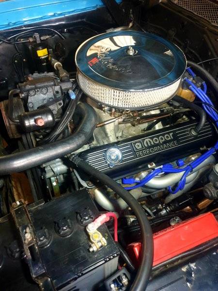

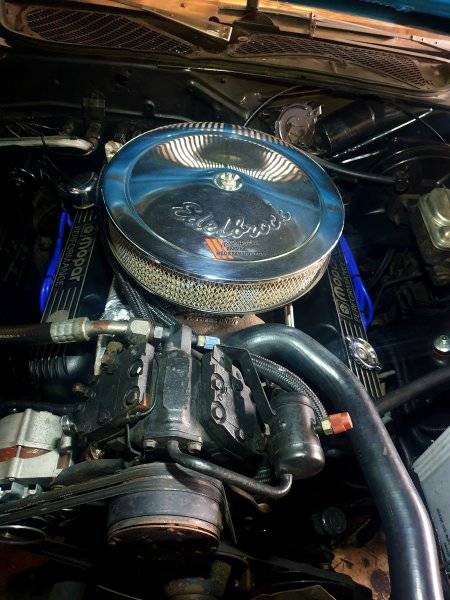

I have a 318 in my 74 charger. I have aftermarket valve covers, as shown in the attached pics, with a cap on both the passenger and driver's side. I'm getting fumes/smoke coming from the caps, which work their way into the interior of the car via the AC vents, which causes a toxic idle.
1. What could be causing the smoke/fumes? I've no idea how many miles are on the engine and think it may need a rebuild?
2. Would a traditional valve cover cap work better for the fumes and smoke or would that just mask an issue?

All I see is caps on both sides. Where's your pcv valve? Air in one breather cap, pcv valve in the other valve cover to a vacuum source on the carburetor.

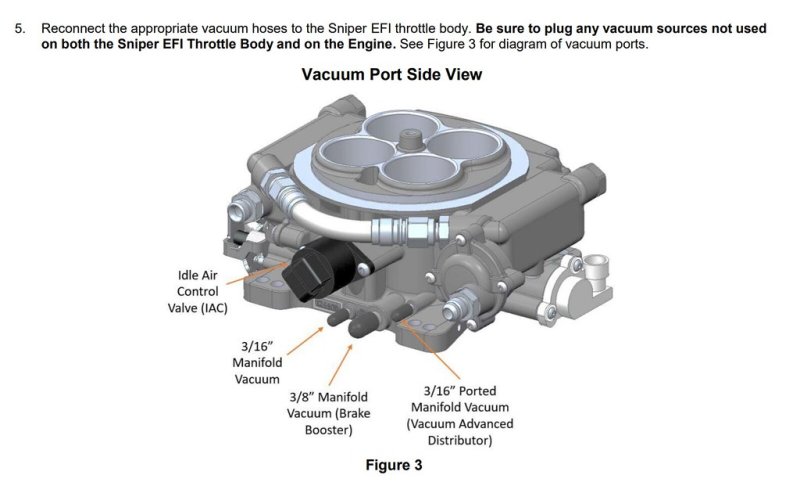

Toolmanmike's info is still valid. Vaccuum source can also come from the manifold itself. There has to be something (PCV valve) on one side, and a breather on the other side to allow fumes to get sucked back into the engine. As the motor wears (more miles) you problem will become even worse.

I cant tell from your pix, but it really looks like those are breathers, not caps....so all you need to do is remove one, find a way to mount a pcv valve in place of that one, and then run a hose back to manifold vacuum as shown.

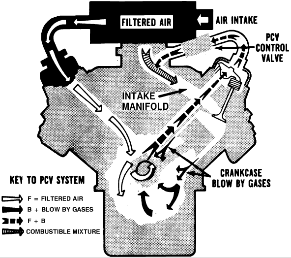

No... look at the drawing.... one side is PCV, the other is air going in(use breather, no cap), A cap would defeat the action of the PCV. It needs a way for air to enter motor.

Remove both caps and snap a photo of the underside and post here. I had this happen on my car. I had installed Mopar Performance cast aluminum valve covers with a basic flat oil filler cap and the other side with a PCV breather cap that looked a lot like yours but with the hose coming off the side plumbed to the intake. I was getting vapor or smoke on the PCV breather cap side. The underside of that cap has breather holes with a crimped edge. The crimped edge was not sealing and was dripping oil or condensated vapor onto my headers and then causing smoke. I removed the breather cap and applied some gray sealant (can't recall what kind) around the underside outside edge seam and that did the trick.

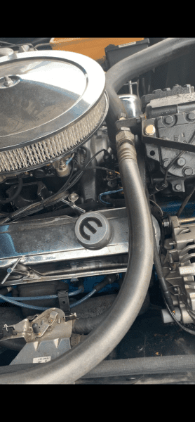

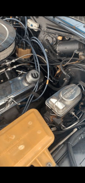

Hey. Thank you! I can see the breather on the passenger side and the cap on the drivers side. Much appreciated!
The PCV valve hose is connected to the port at the base of my carburetor. With EFI you'd have it to another vacuum source.
