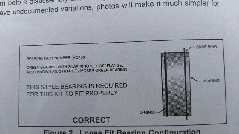

Anyway, the instructions for the 6 piston Wilwood disc brakes (12.88 dia front, 12.19 diameter rear) call for the "Strange/Moser" green bearings with snap ring "loose" flange part# MO400...
Well of course Cass aka Dr. Diff had them, and even replied to my (central time) late night email, with a link to his website to buy them, which I did.
Can anyone shed some light on WHY these are required, and while I've always heard they are "better" than the factory adjustable bearings, I have no idea why.
Educate me please!

this post isn't about what's better....it's about what you can use when adding disc brakes to a semi floating rear end like the 8 3/4 and the Dana 60 car rears that use the tapered roller bearings

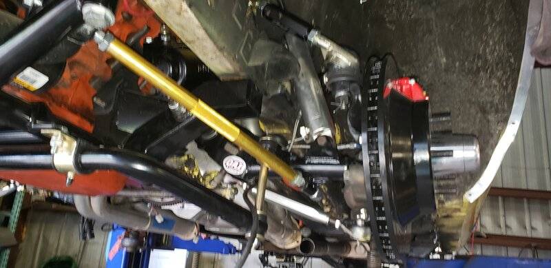

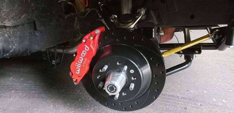

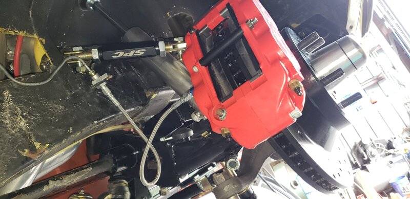

Roadrunner work is coming along. Strange chromoly steel driveshaft and 1350 solid U-joints are installed, and when my bearings come in Monday, by Tuesday she will be shod with these beautiful brakes on all 4 corners:

NOW I'm going to have the Strange/Moser style of green bearings, because that is what my beautiful bright red, 6 piston Wilwood rear disc brakes (w/parking brake mini-drum option, of course) REQUIRE.
View attachment 988358 View attachment 988359 View attachment 988360
Man, you need to do some upgrades on that front end!! :lol:

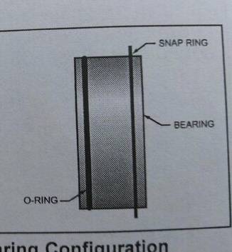

Is the snap ring on the Green bearing the only thing holding the axle in the housing?
The snap ring keeps the bearing from going back into the housing. The outer part of the bearing is held in place by the backing plate just like the taypered bearing and holds the axle from coming out.
