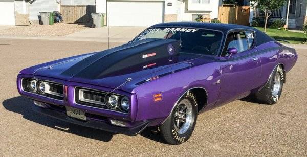

I will be needing new sneakers for my 71 charger, in the semi-near future. I was wondering what are the widest 15's that will fit without rubbing.
:thumbsup:
With stock springs a 9.5 wide rim is a nice fit.
Dr. Diff makes an offset shackle that gives you 3/4” more room.
Usually depending on the bulge of the rubber a 4.5- 4 3/4” BS is about max you can get.
I have a 4 link and can fit a 5.5 BS rim on my Charger.
I have the year one rallye wheels in an 8x17, they have a 4.25" back spacing and using a 255/50 tire, they fit with 1.5" of clearance to the factory HD springs with plenty of room to the 1/4 panel. I am considering going to the 9" rim that have a 5" back space and some 305/45r17 Mickey Thompson SS tires, might be a little close to the spring without offset hangers, anyone used these on a 71 Charger.
