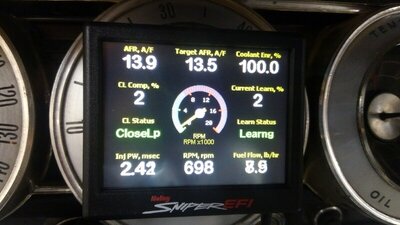

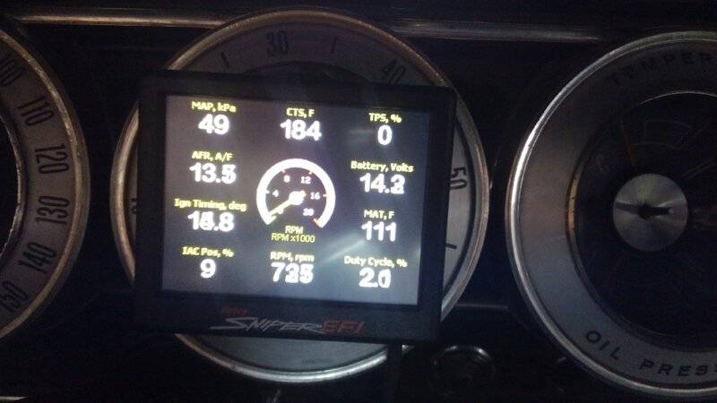

Update; Have wicked spark at each plug wire, have gone so as to check cooling system for combustion gases. Tracking down a leak down tester now. Now wondering if anything appears amiss with these sensor readouts;
A miss could be most anything but you might be able to track it down using the data logger. The built in data logger is a super cool feature on the Sniper. Take a data log showing the miss and post it on here as well as a copy of your current config file and I'll take a look.

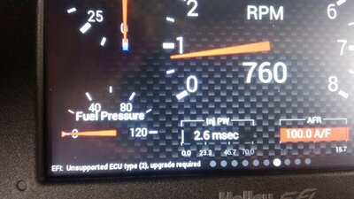

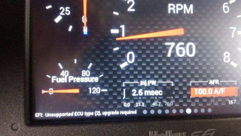

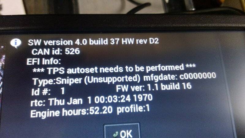

I thought I could hook up this Holley dash and get the data log and config file but get these messages...
