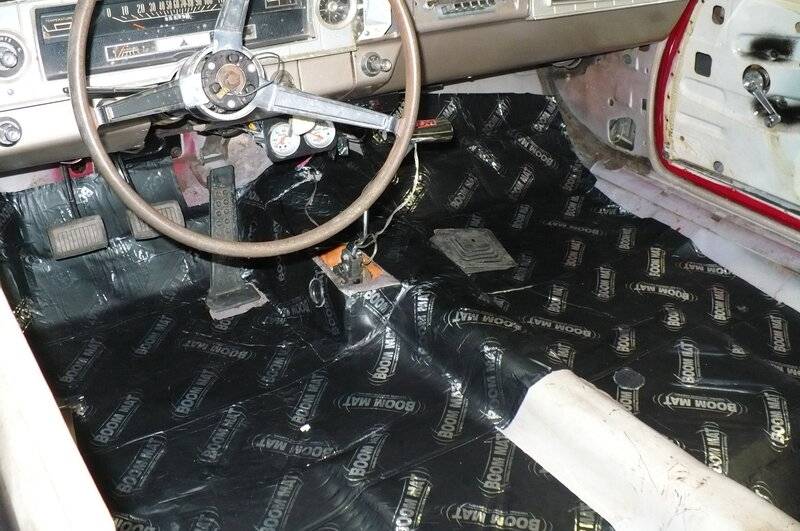

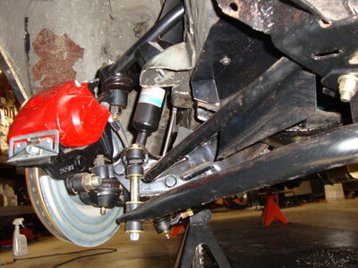

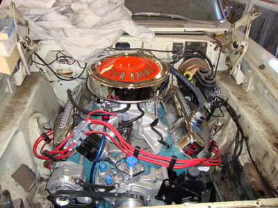

Hello everbody. I've finally joined up. I have a 1965 Coronet 500 that I have been working off and on for about 8 years or so. originally a 361 auto car, it is now a 440 30 over, edelbrock intake /rpm cam/800 cfm carb. I swithed to a passon performance hemi overdrive 4-speed, been on the 5-speed list forever. Most likely stick with the 4-speed. Trying to get car finnished up and on the street. not a restoration just a fun car. been dealing with the dreaded cowl rust and rear wheel arches. Should of bought the patch panels 8 years ago , all dried up now.These cars are sure hard to get parts for. took 3 years of searching to find a 4-speed top plate for the console. I've watched a lot of parts slip by on this site, I don;t know I haven't joined till now. looking forward to advise from you guys on these Mopars. I hope I can just get it going and have some fun before they make me put a electric motor in it!

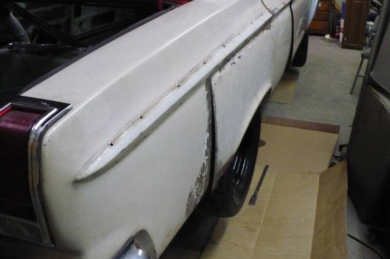

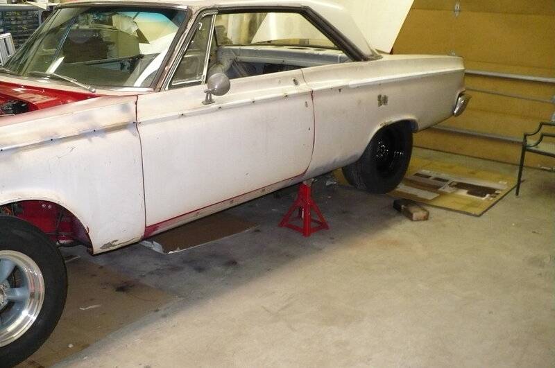

Thanks to everybody for the welcome. Still trying to find patch panels for rear quarters. i'm thinking of cutting outer wheel house loose and fixing the wheel arches with sheet metal of fiberglass , then installing some rolled metal out to the inside of the fender with a rubber push on seal up against the inside of fender , Kind of like a mini tub . Might give more tire room also. I saw an article about doing this very thing and using 3m adhesive and spot welds or rivets, then spraying on undercoating. what do you guys think?. I have looked at some push on rubber seals with wiper edge , they look like they would be the perfect thing to use there. I just figure my body work skills are lacking ,so it would be easier to just deal with the fender by itself and not try to weld or attach the wheel house the the fender.
