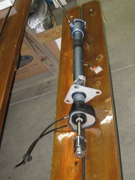

Hi fellas,
Well, I need some help! I pulled the steering column out to clean up the firewall and one thing led to another and I am ripping the complete column apart. I'm down to the shift tube (automatic 1965 Coronet) and I can't see what fastens the outside casting (the part the shifter lever is pinned into) to the inner tube. I can see it has to come apart at the top and the tube exits out the bottom of the main column tube/housing. Has anyone done this? Help!

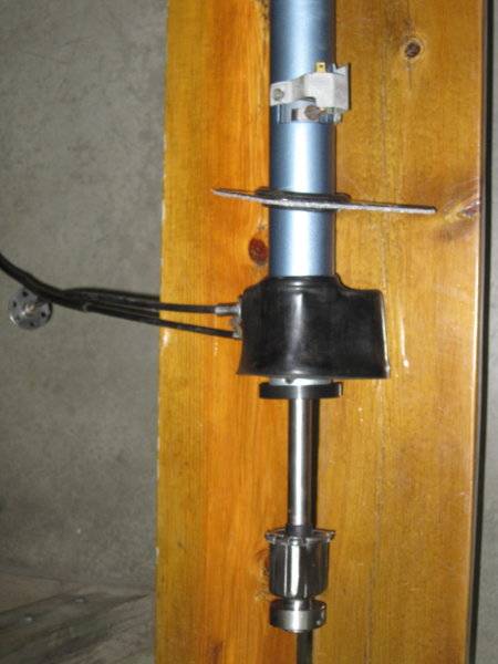

I finished disassembly this AM. I needed a 9/64" allen wrench to remove the screw that retains the selector collar to the shift tube. It wasn't with out problems though, I forgot to remove the "finger" that activates the reverse lamp switch and broke it of course. Now I need a replacement.
Mike
Up date: I finished the column, had to weld the reverse lamp switch actuator. Found the column information and adjustments in the transmission section!
