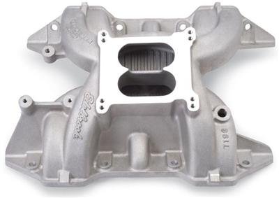

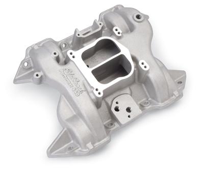

You need to get your intakes straight my friend. First off, Edelbrock does not make an Air Gap for the big block. They are all already air gaps......even the stock intakes. Since big block engines have an intake valley pan, air flows all around the intake on a big block. The intake I am talking about is called the Edelbrock Performer. PERIOD. What you are referring to is the Edelbrock Performer RPM. Two completely different intakes. One is pretty much a stock replacement, but made from aluminum. The other is one of the best intakes you can get. Big difference. Here's a comparison. The first one is the Performer. It looks just like a stock intake. The second is The Performer RPM. A blind man could see the difference. lol

Dont know why Edelbrock has 2 intakes with such similar names. The 440 Performer performs poorly according to IQ 52 and others. But the Performer RPM is a great intake. I have one and it worked great on my 440. There is also a 383 performer. Similar to the stocker, just lighter weight aluminum. But lacking in the performance dept. I would go with the Performer RPM, and a cam in the range of .484 lift, 284 total duration. A cam like the 509 lift, 292 duration would be the most you would need for a stock type street engine. And that may be too much. Wont work with power brakes.
Great description, Gary. Finally somebody that understands what I'm sayin. lol That's why when anyone asks, I recommend either the Performer RPM OR one of the other such as the Weiand. You can see the huge difference between the Weiand and the regular performer. I call the Weiand a happy median for those who might not want to spend such a chunk on the Performer RPM. Of course, you can always hawk ebay for a CH4B or similar old school intake. Some of those older pieces really come close to the Performer RPM and can be had very reasonably.

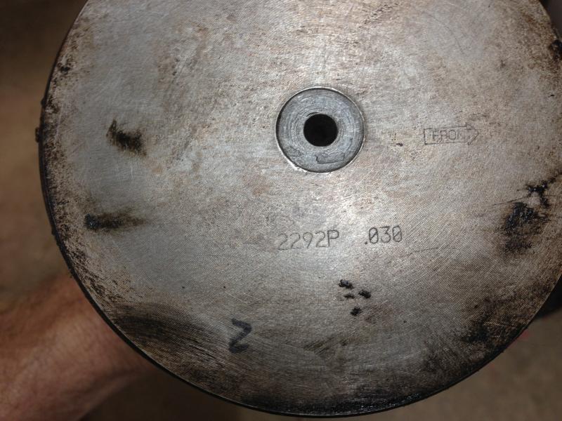

Would the Performer RPM fit under the hood? I remember size being a factor earlier in this thread. Also, my dad took a look at the pistons, they are flat top and they have this printed on the top: 2292p 030. Can you guys tell me what this means?
Heres a picture:IMG_8471-2.jpg
