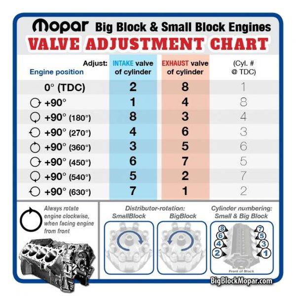

For each cylinder: exhaust starts to open-adjust the intake, intake just finished closing-adjust the exhaust. Seeing how the lifters are filled with oil, loosen the adjuster until the pushrod will move up and down with your fingers. Then, slowly tighten adjuster until the pushrod play stops, and turn the adjuster an additional full turn. This will set the lifter preload.
Try this:
You don’t adjust hydraulic lifters while running, at least I’ve never done that. No matter what method, you need the lifter on the base circle of the cam. Get to zero load like mentioned, I typically only go 1/2 - 3/4 turn. Splitting hairs at that point but you shouldn’t be snapping anything.

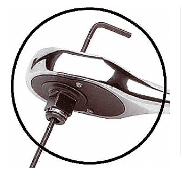

On Hydraulics I assure you it can be done running, they use to sell a tool just for it see photo...
Yes stud mounted rockers are easier but adjusters on the arm aren't that hard once you have the technique down... You hold the wrench loosely to allow it to move some with the rocker....
