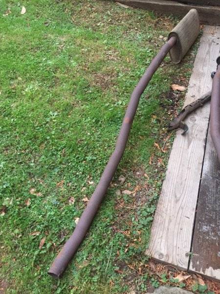

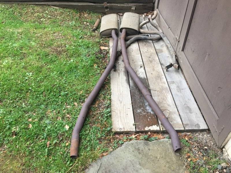

Picture "Update"

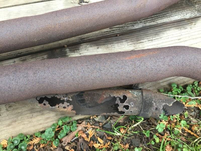

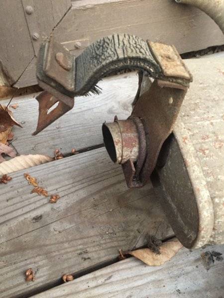

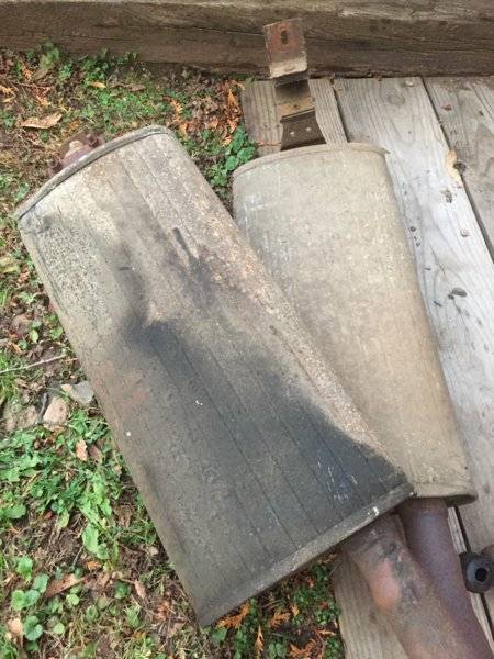

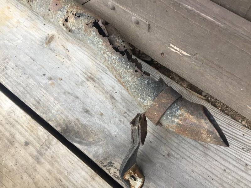

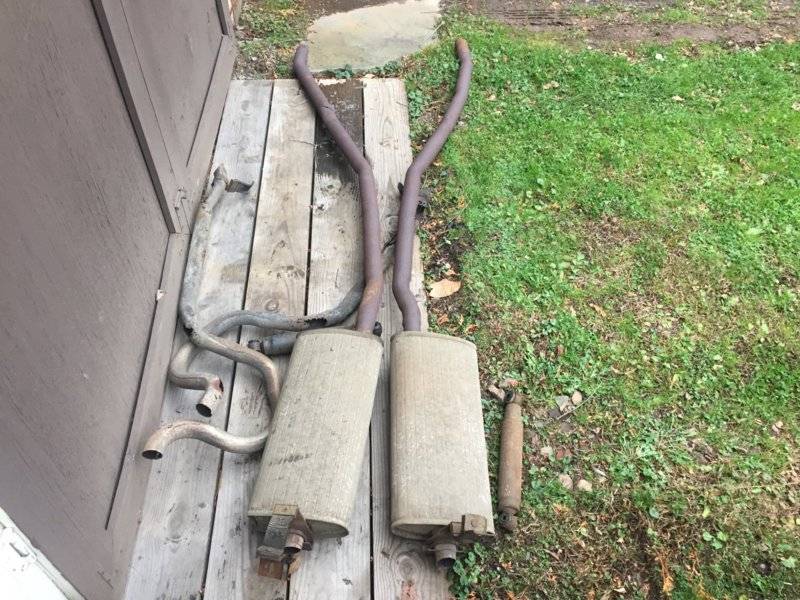

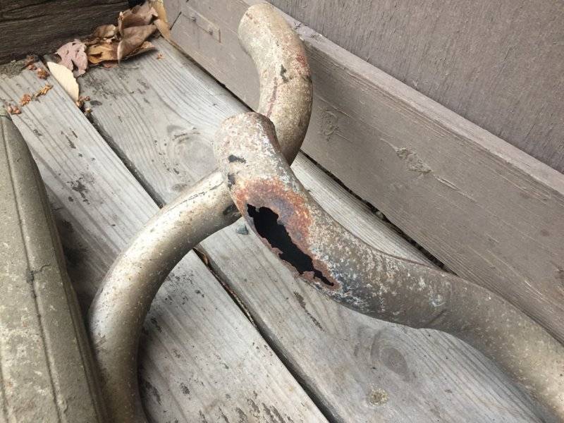

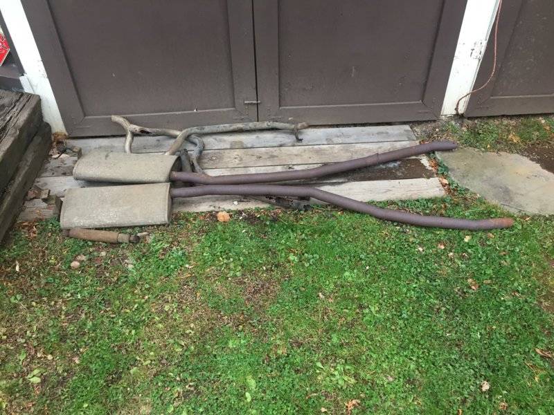

The old exhaust. We thought it was the original 1966 exhaust but it wasn't. The exhaust had the "dip" in it so it wouldn't hit the frame, but turns out it is an exhaust from Midas. The tailpipes were rotted out and no good. The original shocks were ok but we wanted new stuff.

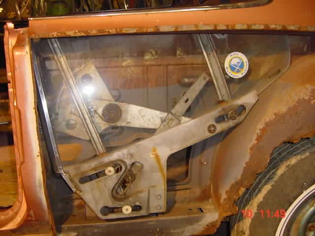

4) Follow side window installation instruction religiously. Religiously! Snap on clips suck, I used a socket that went over the clip taped to a pair of channel locks. Worked well. But it still sucks.

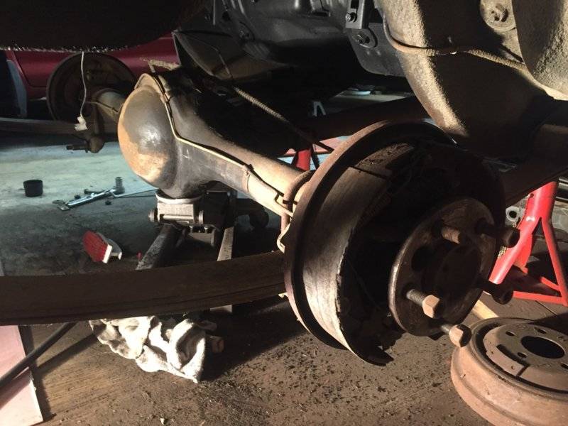

Gas tank back from being gone through/cleaned/rebuilt etc, and some brake work done also. Saw that on the right rear brake that I believe the return spring was missing. It was completely gone/non existent. Put on/shortened a '67 c-body (Fury) one. Otherwise not much else done sine then.

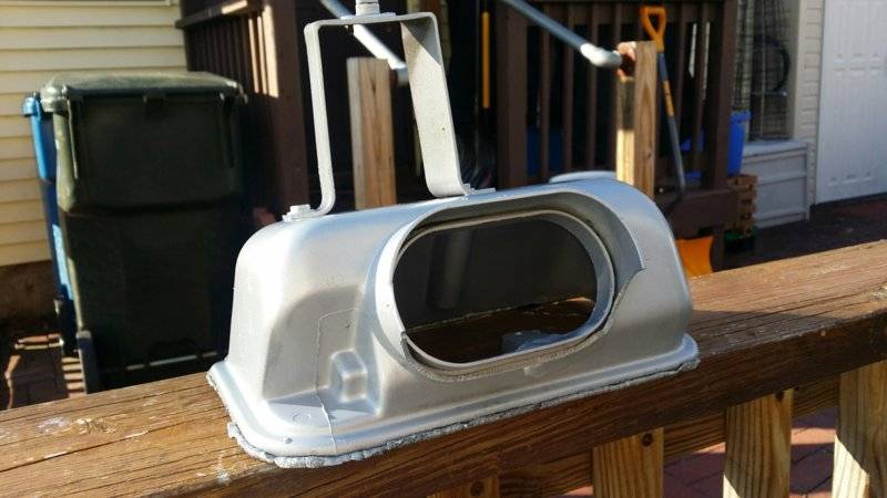

The gas tank came back from the shop cleaned out. My stepdad painted it silver and it is now back in the car. The gas tank I believe filler is being worked on as we speak as far as I know. I believe 2 rare rear bumper parts are painted as well.

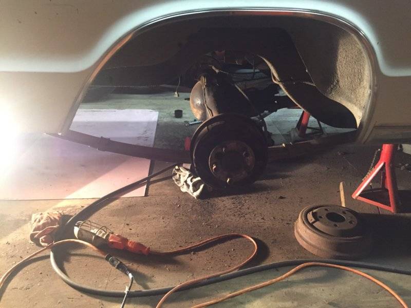

The rear drum brakes are now rebuilt with lines and everything, they are going to stay drums while the front is getting disc.

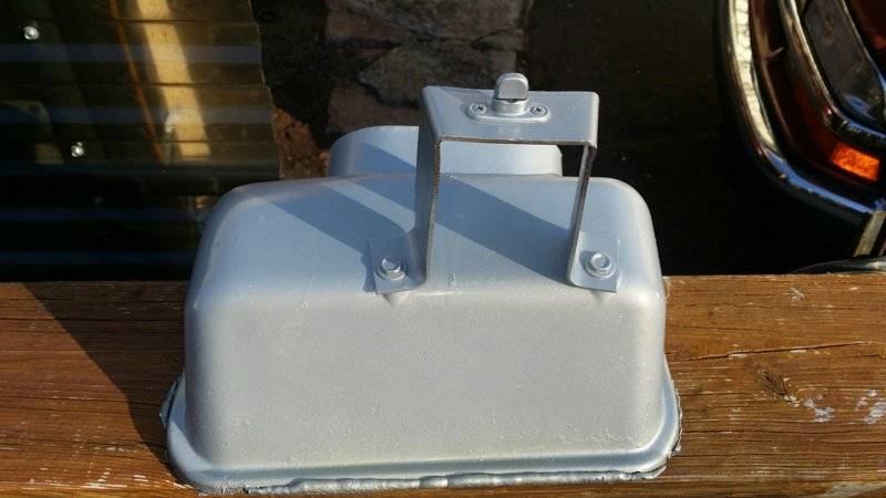

Not much done to the Charger lately. Just the gas tank piece painted and put back in the car. Here are a couple pictures of it painted
