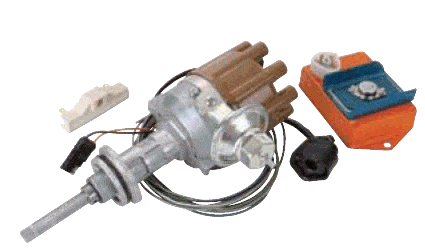

b. ELONGATE YOUR IGNITION COIL WIRE DUE TO DISTRIBUTOR LOCATED IN FRONT OF ENGINE, NOT NEXT TO FIREWALL AS IN SMALL BLOCK CARS (if you are using points, disregard)
images
c. RECOMMEND UPGRADING TO ELECTRONIC IGNITION

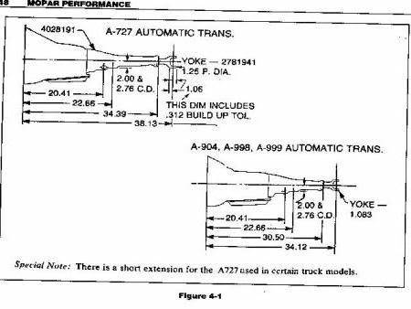

d. SHORTEN DRIVESHAFT 4 1/8” TO ACCOMMODATE FOR LONGER 727 TRANSMISSION

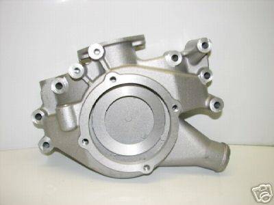

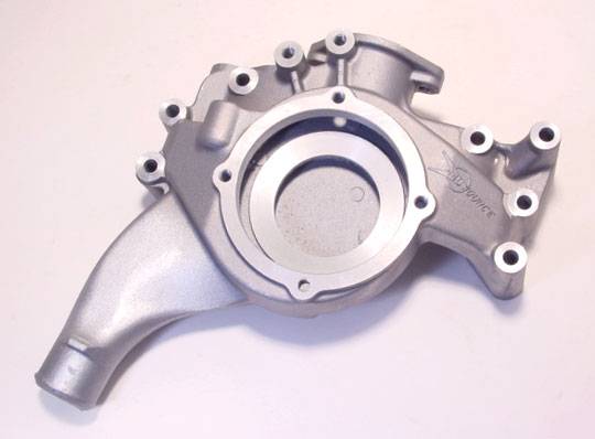

g. RECOMMEND LARGER RADIATOR OR RADIATOR WITH BETTER COOLING CAPACITY
h. INSURE WATER PUMP HOUSING INLET AND OUTLET’S MATCH RADIATOR INLET/OUTLET

i. SHORTEN DRIVESHAFT 4 1/8” TO ACCOMMODATE FOR LONGER 727 TRANSMISSION

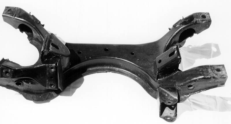

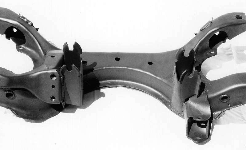

K-MEMBER IDENTIFICATION
68-72
73 +

You have to ensure that the pan you do intend to purchase will clear your k-member and centerlink so that there are no obstructions. If you use the wrong pan, your engine will either:
1) hit your centerlink, thus not allowing it to set properly
OR
2) rest on or close to your k-member so that it will not mate to the transmission.

402 pan WILL NOT work in a 73/74 k member. 73/74 k members require <------ a 971 pan. The 971 pan was the pan that came with the 73+ BB, B body mopars. 402 pans were 66-71 BB, B/E body mopars.
im not 100% positive but was told that this pan came off of a 73 rr wishwas in a 73 rr with a 400 bb dam not i have to find a difren pan grrrr
sorry dude, I really am, but if you put that pan in there, you will find yourself seeing your engine rest on your front k member and not mate to your transmission.
