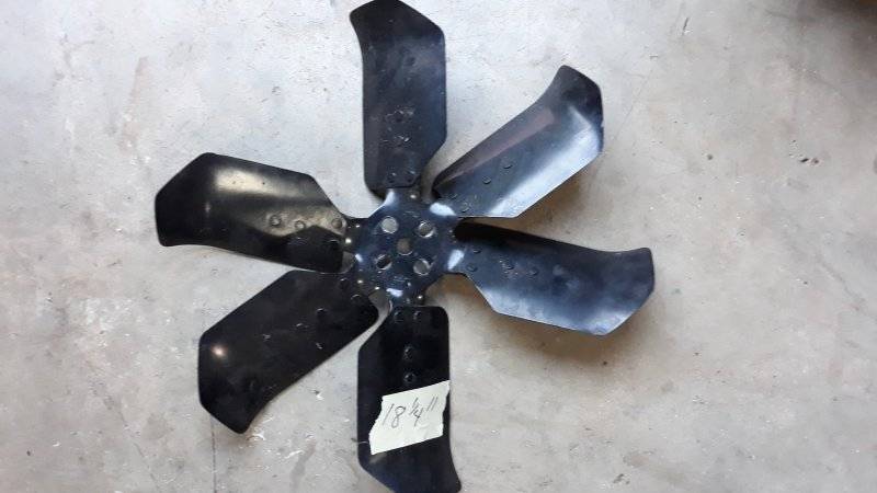

Hi, Hope I’m doing this right. Looking for a solid fan. I’ll worry about spacer after measurements. I don’t want the clutch fan anymore. Read where others changed to it. Solved overheating problem.22” radiator, 18” 7 blade, no clutch. Thanks.
You should determine what diameter fan your looking for. It'll be much easier to get what you need. 440'

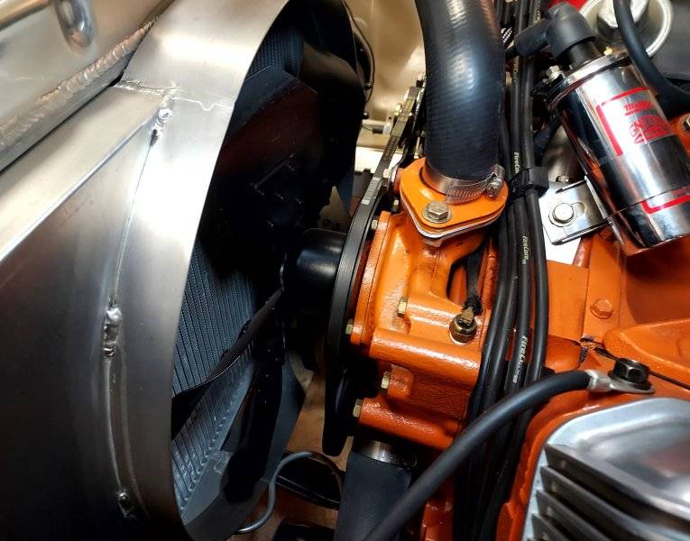

This one's rated for 8,000 rpm. The other I posted was 6,000. Do your own research and measurements on these. Might be differences in the center hole dia. I'll look for my receipt on the one I bought. A fan shroud is the trick for a good setup. One third of the blade showing out of the shroud. It doesn't matter the distance from the radiator as long as it's not too close.

Both of my pullys are 7". No spacer. The widest part of the fan blade is 2" from the radiator. 1" clearance inside the shroud. 1/3 of the blade out of the shroud.
