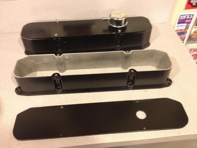

I see big differences between hot and cold. I have a comp cam and al heads. I set cold allowing what comp recommends. I was told by other pro drag racers to set one hot then check it after the engine is completely cold and make the adjustments at that point 2014-11-20 15.19.50.jpg.these valve covers make it easy to adjust hot with no mess.
