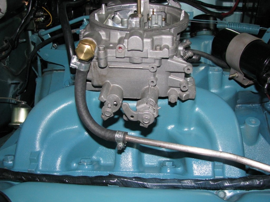

One more thing you need also to add Mancini throttle return kit Item #: AR1060 and Edelbrock 8089 - Edelbrock Carburetor Fuel Inlet Fittings if you still use stock fuel line.

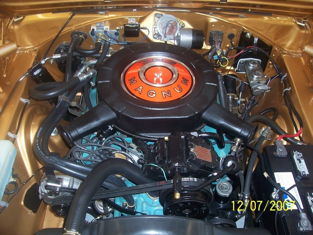

I also run the RPM on my 451 under the stock flat hood. I did similar to the post above, with a drop base and the upper half of my stock air cleaner. Ran that way for a while, then eventually gave in to the desire for free hp via cooler air. Went to this:

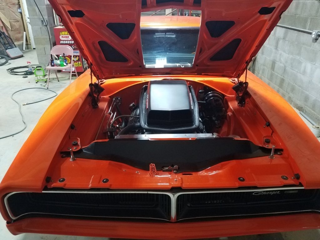

I'm going to do whatever I need to so I can use a dual snorkel Mopar air cleaner on mine for the stock look except that mine is now an m1 intake and quick fuel 950hp and small nitrous plate. Gonna mock it up and get it figured out, I'll post pics.
I know most think it's weird but I just can't stand the non stock appearing air cleaners on Mopars tho I tolerate the Mopar performance one. I don't even like cast aluminum heads, gotta be painted on Mopars for me.
Description of that new air cleaner..brand and where obtained. I like that...................MO

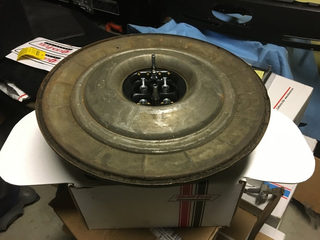

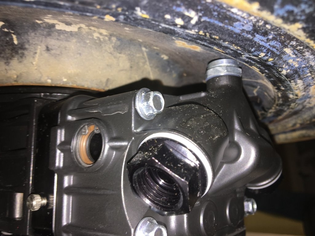

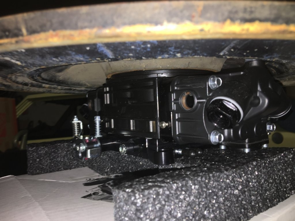

I want to run a dual snorkel under my flat hood on my 66 charger (I know 66 didn't come with them but 67 did, close enough). I'm running rb block with trickflow heads, stock k member and steel moroso mounts. M1 intake with quick fuel 950 and small nitrous plate that measures .425 inch.

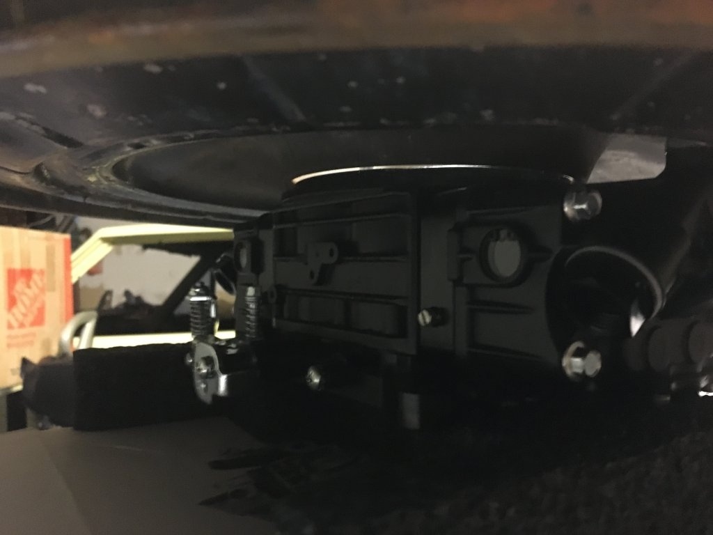

So far I have only ran into the air cleaner base resting on the float bowl screws. I can modify this easily but have to make sure that after I do, the throttle lever doesn't hit the base as I pull through to full throttle.

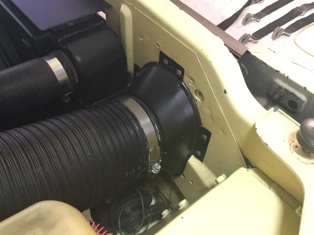

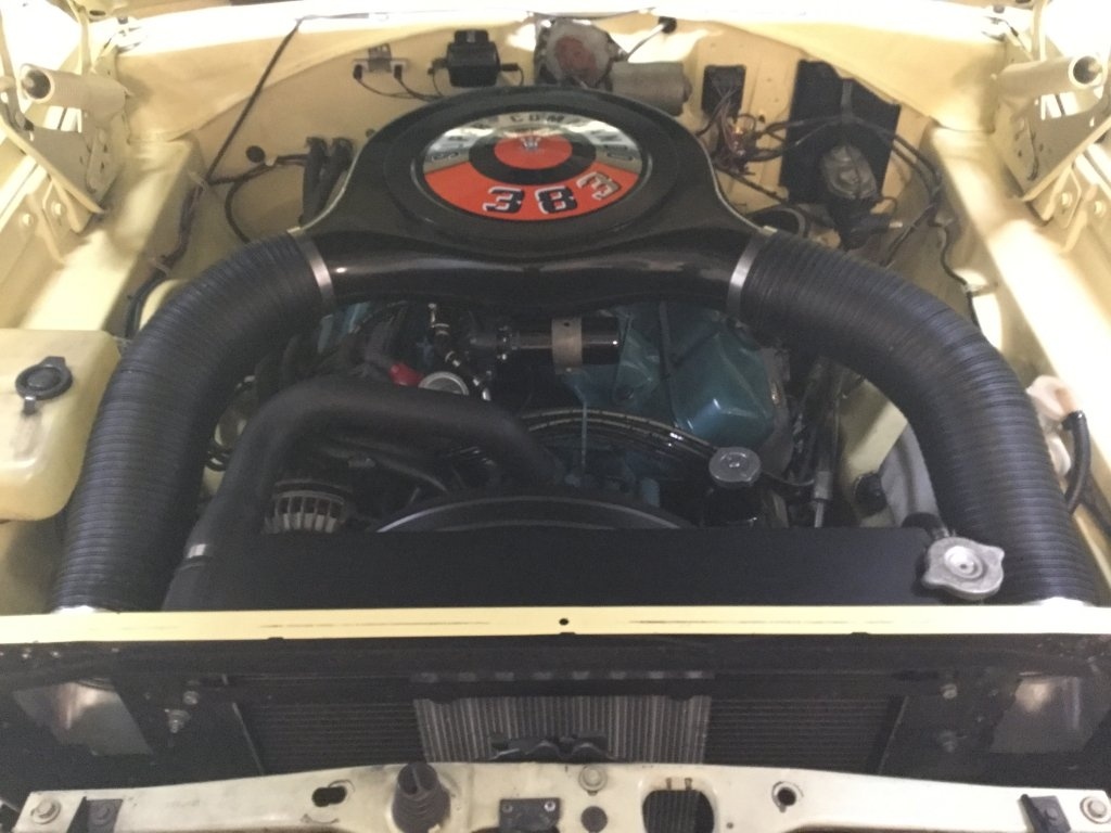

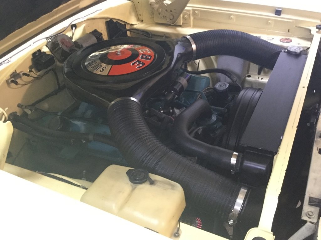

I used 4" flex-tube and fabbed the airhorns at the core-support from have material also.

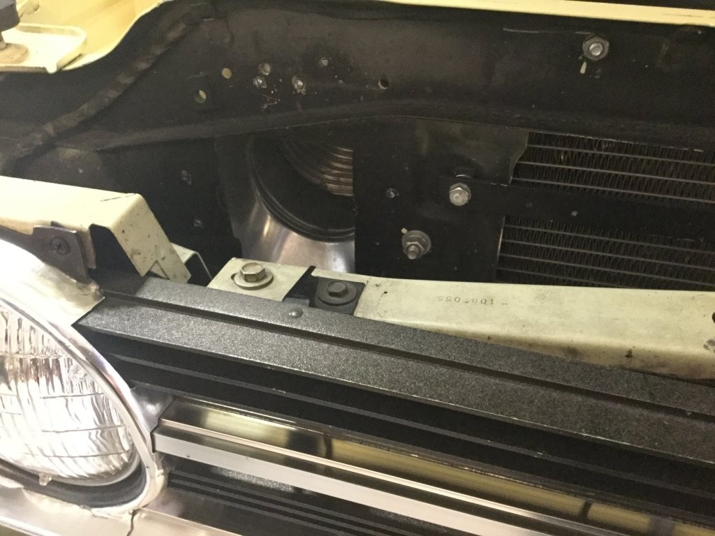

Mine is more complicated. I want the inlets to be the inside headlight buckets. . That will require ducting thru the inner fender and fabrication. . I am using the Spectre air cleaner. I had it powder coated wrinkle black and just picked it up today. Also found a shop that would take on the ducting work, today. ...You did a nice job..............................MO
Getting to the headlight buckets in a B body is tough. Typically there is a triangulated intermediate brace between the core support and the grille that is in the way. But if you can make it work, the same guy at ramairbox.com has some spun aluminum headlight ducts as well.
