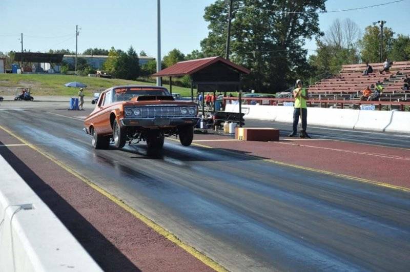

After a number of years playing in the modern Hemi arena, I picked this car up to have something old school to run as well.
I only have three passes on it because the first two resulted in a little more front end lift than I expected and more of a problem was the landing.
in slow motion, the front wheels wobbled something terrible on landing. I mean scary looking.
So the last pass I tightened the front QA1s up like 6 clicks and that resulted in a ton less front end lift and the car went 5.99 in the 1/8th. I need to get this thing sorted out.
SO outside of making sure nothing is completely wore out, what direction should I go?

My experience is they will wobble if it lands hard. My belief is this phenomenon happens do to the change in front track width. As the suspension droops the track narrows. Tight front rebound has definately has helped mine. I've seen cars do it with solid bushings.

I think that as you become comfortable driving your car and drive thru the wheels up, the wobble will subside considerably. As long as the front end doesn't get too high. This will allow the front too settle smoothly, from my experience...:moparsmiley:

Should probably look at the rear shocks, too. They should be valved / adjusted to work in conjunction with the front to provide the desired weight transfer, but limit losing drive-ability (pulling the front off the ground). Have not seen too many QA1 drag setups, mostly JRi, Lakewood, and CE.

Check the alignment. The old school trick was to measure the toe change through range of suspension travel, if IRC then bend center link to minimize the amount of change. Limiting up travel will tend to minimize the change on landing. You will get used to the lift. The car is beautiful, and fast.
Alignment and zero toe pattern will not correct this condition. The key is a smooth landing. The harder the front end falls, the worse it gets.

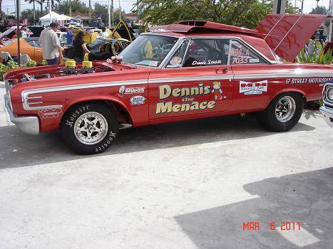

Beautiful car. I can't help with suspension settings. Our '63 is a "land lover"...never pulls the wheels. Is your car the old "Dennis the Mennace" car? Looks very similar. I think the owner lived in Florida last I heard. Good luck.
Yes, the car is the old "Dennis the Mennace" car.
