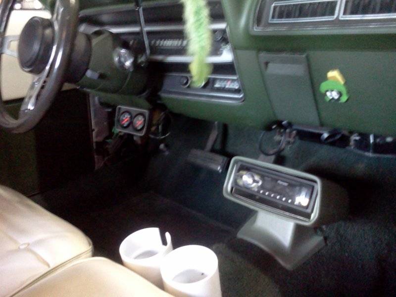

Some folks were asking about my buddy seat mounted cup holders-

I had the BS out today so I took a couple pics.

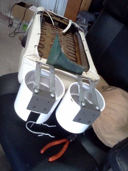

Looks like I used the same bolts that secure the BS to the front bracket.
(yes, I know the bracket is supposed to be welded to the floor)

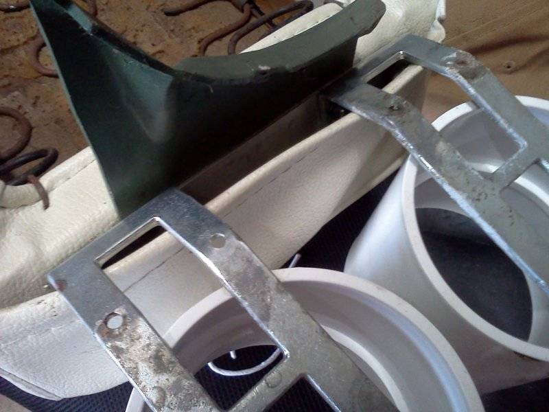

I bent some long 19" rack mount equipment "ears" right at the weak spot where there were screw holes (hey, sometimes "Murphy's" law works for you).
Then I screwed a small ear to each of those, and than a PVC pipe coupling to the small brackets. One coupling has been notched to clear a coffee cup handle. Still need to do the other one.
They hold a can loose but are tall enough for it not to tip.
(even during "spirited" driving)
They hold a "standard" coffee cup perfectly.
They rest on the center ridge in the coupling.
They hold a Circle-K "Polar Pop" fairly securely.
