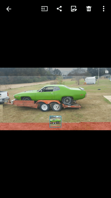

I don't wanna call it a restoration, it's not going all back to factory.
Son is almost 14, saved up his money to buy this car. I will be helping him rebuild it, teaching him as we go.

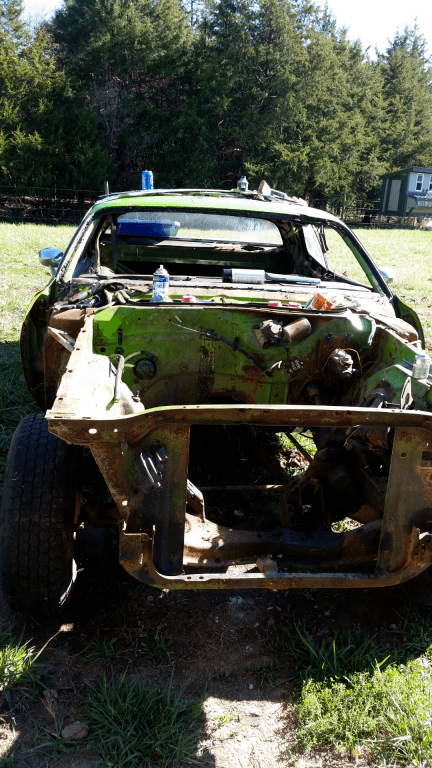

Since we got the car in October we have done a lot of disassembly, finding a lot more rust and body filler than we thought it had. Nothing really surprising as I know these old mopars have their spots they like to rust. We are going to tackle the car a section at a time. Here's some pics thus far.
Uploading from my phone, so hang with me..lol

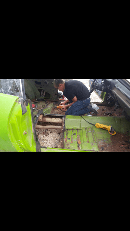

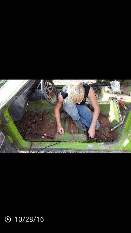

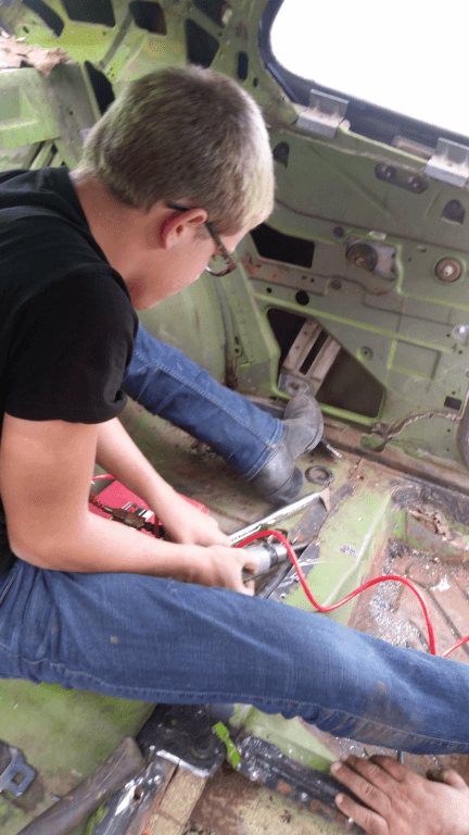

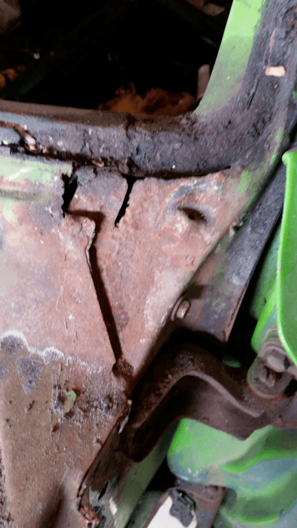

Scraping seam sealer getting ready to drill spot welds on the floor

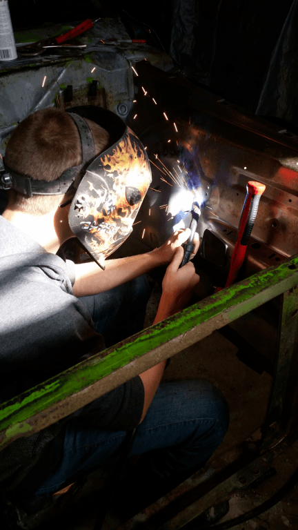

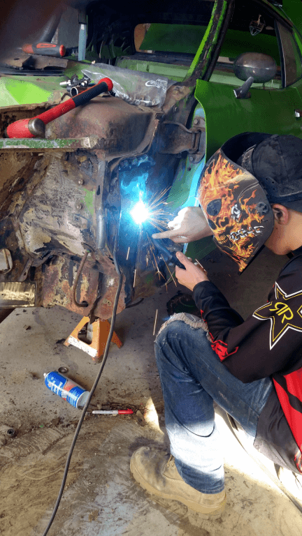

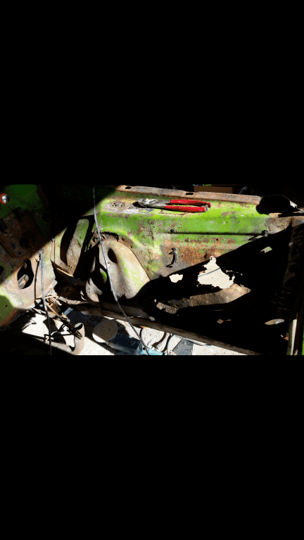

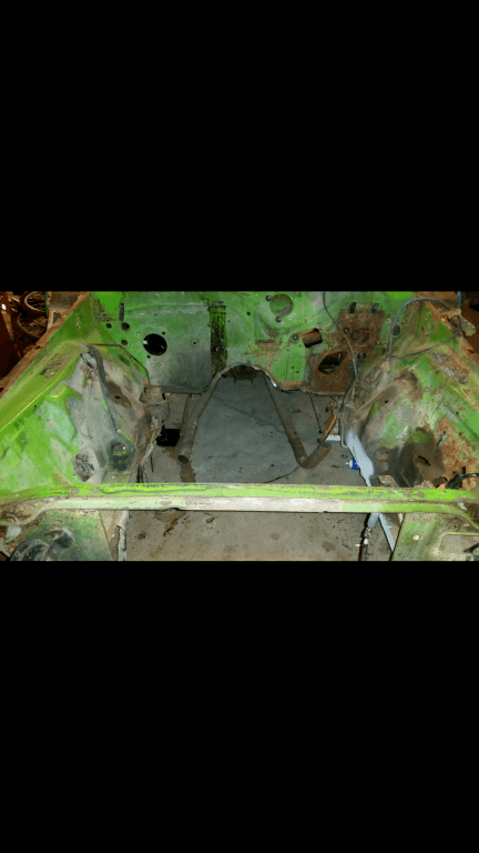

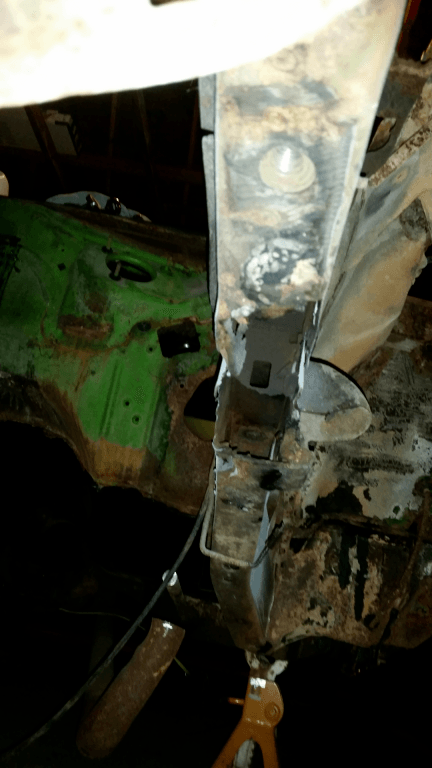

Surprise frame rot, cut the bad out, patched those sections, capped the entire rail with 14g and full length welded

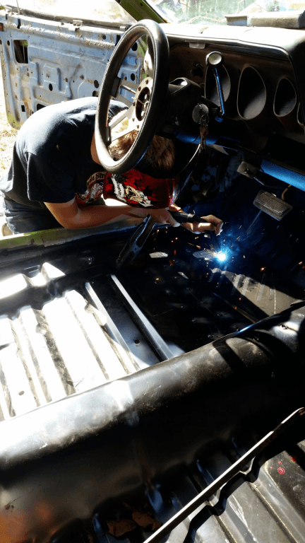

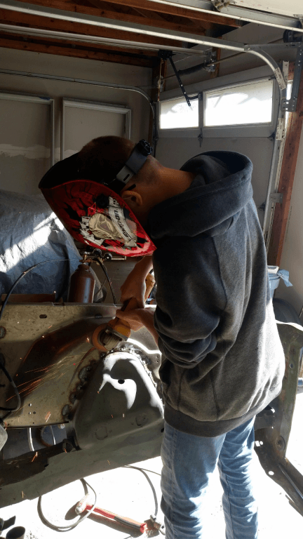

My oldest son welding in some new sheet metal

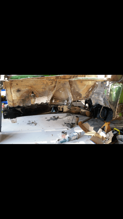

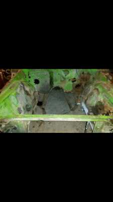

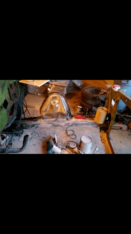

Inner removed, everything stripped, rust treated with ospho and primed

Grinding down his ugly welds. Lol. I'll go back while he's at school and fill his burn through and touch everything up.
Only way to learn is to grab the welder and do it I told him.

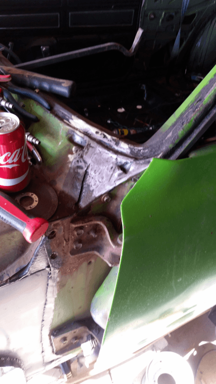

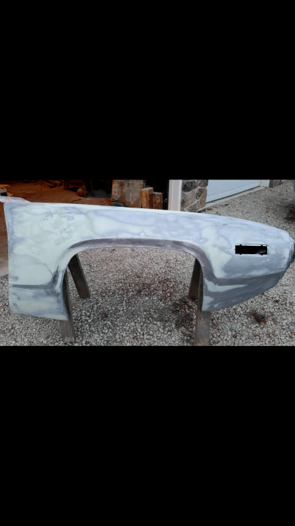

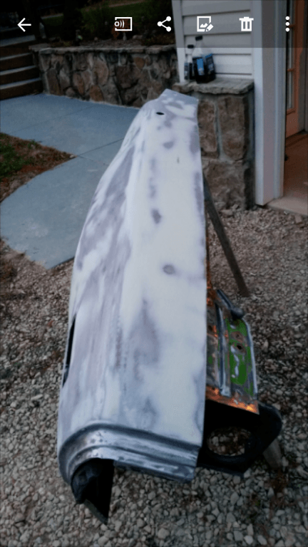

Spent a lot of time straightening this fender. Finally got it where I believe it should be. I'll fit it tomorrow, if everything lines up as it should, comes back off and gets epoxy primer. Then on to the other side
