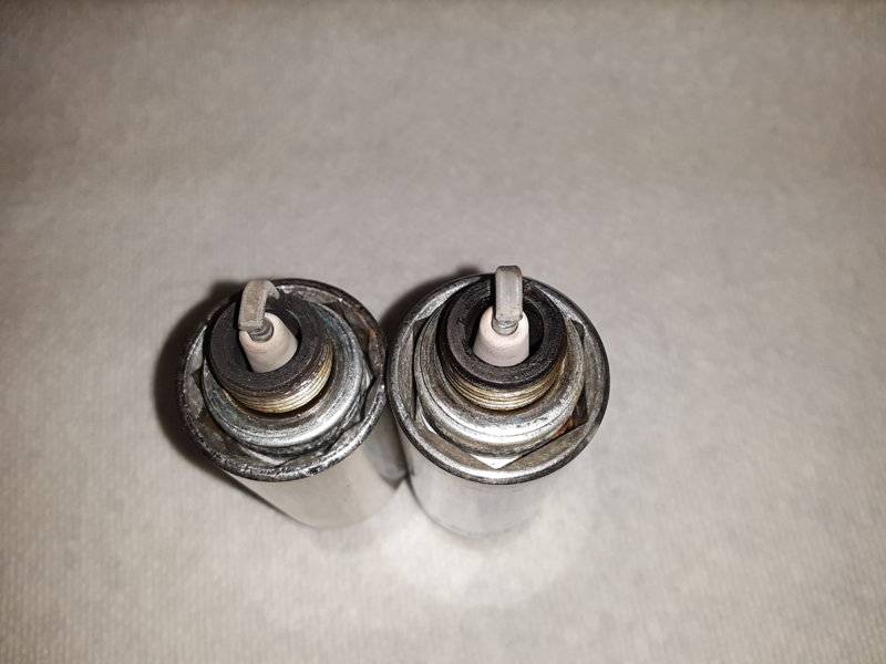

I just put pics of 2 plugs on, all 8 look the same. Champion 12s gap at .040
440 with pertronix ,750 edelbrock . close to 900 miles on this set
I didn't think they were to bad . What do you guys think ? rich? lean ? ok?

Look great to me. Is there a reason you pulled them?
tinge lean looking , i have to say mine are the same colour , and 10 000 miles on her since rebuilt my /6 with twin Webers and 268 cam
Thanks guys, I pulled all 8 just to have a look. The 440 is the one I installed last summer. Its been running fine but has that typical water your eyes back bumper aroma.
I know lean or rich can cause that but crap I don't know what way to go lol.

to me the rim of the plug looks a little rich and maybe a little too much timing. I think a vacuum advance can show a little too much timing though. if it runs and drives fine then maybe leave it alone. I don't think iron heads are easy to set up carbs anymore. the crummy gas and combustion chambers do create a challenge.
Thanks lewtot, yes its running fine and starts good hot. I will not hurt to try to back off the timing a little. That may help clean up the exhaust a little.
