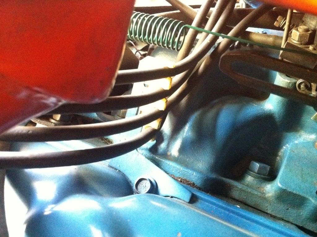

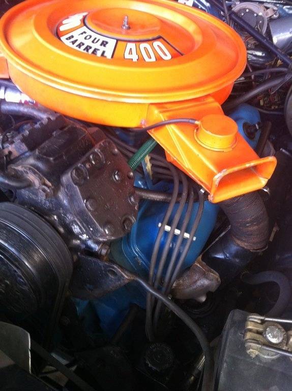

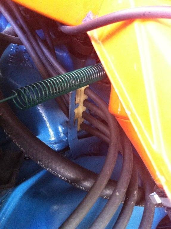

I have had these pics on my cell phone since jan 2013. They are firecore250 wires
Thanks Nacho,
Here is another one to add to your collection. Nice clean job too, very neat.
That's what I will be doing. Gotta find that one piece on the intake near the dizzy.
The one bolted to the cover I have.

That one got an extra bracket close to the distribuitor but is actually incorrect. 73 and lates BB just got those two plastic brackets to the driver side and one to passenger side attached to the manifold stud just right behind the alt.
well at least for AC cars!... non AC could got that one instead the valve cover bolt one ? dunno
