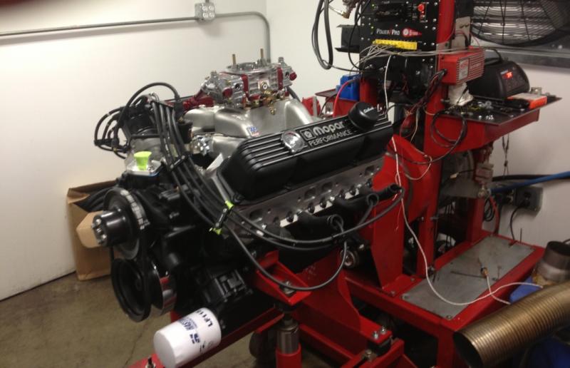

I've routed mine just like the factory. Using all the mounting bracket. Been using the http://www.firecore50.com/index.html wires from the beginning.
I'll second the Firecore 50 wires. Real good wire and like Copper mentioned, outstanding customer service. Give'em a ring. They'll custom cut them for your application or supply an OEM length.

Are those custom cut Will? Are all 8 using 45* ends? I was thinking straights would work the best, but maybe not after seeing yours.

I'm using the 45* ends on all 8 Joel, and fitment is good with the Doug's 2" Headers. I'm running eddy heads, so my plugs are angled. The set I have are a universal set for Big Block Mopar. Not exact to factory spec's, but the length is still sufficient for the mod's vs. OEM without stretching too short or leaving a bunch of slack dangling all over the engine bay. I'd give them a ring if you do plan on getting a set. They'll ask what's bolted on your motor and work with you on options to get the best configuration.
