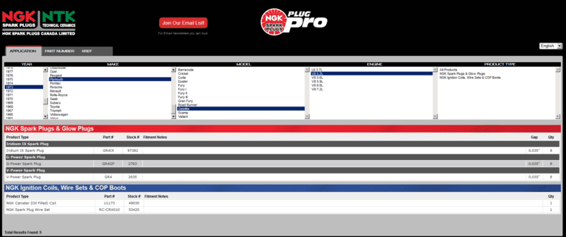

Here's the listing from the NGK website.....

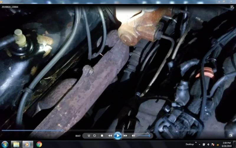

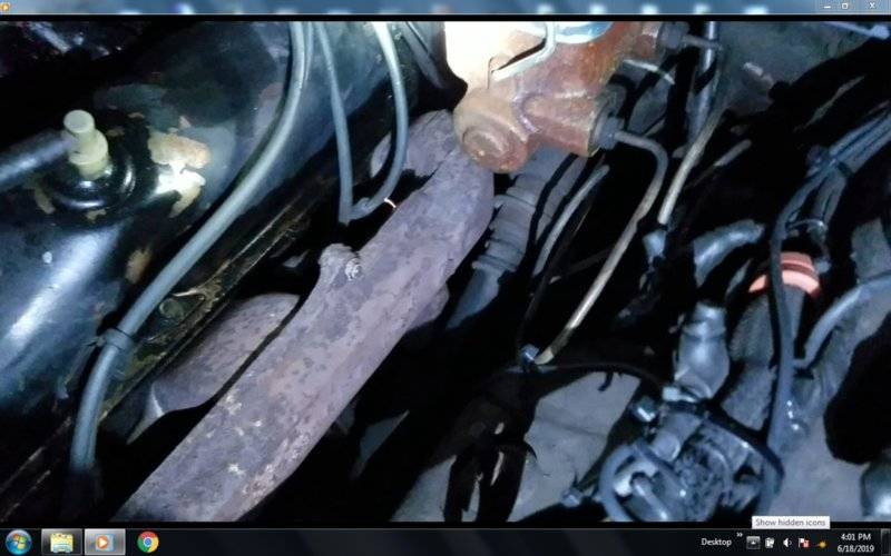

Many variables, but if you are running a basic stock 318.
(This one has 360 heads. Cop motor).
My daily driver.
Almost 80 miles a day 5 days a week for 15 years and across country twice before that.
Two nights ago it started running rough on the way home from work.

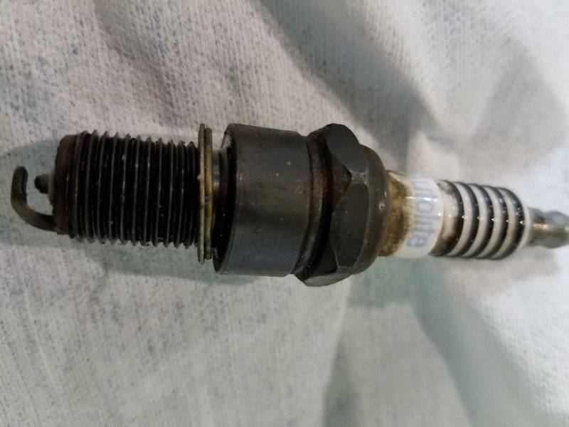

What I found.

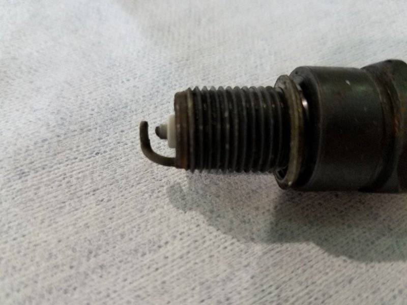

This is the second time I've worn out AP65s in it that I remember.
Can't say for sure that I've ever run anything else.
Tips eroded and the car was still running fine.
That's what I use.

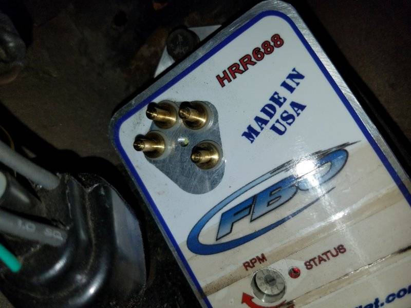

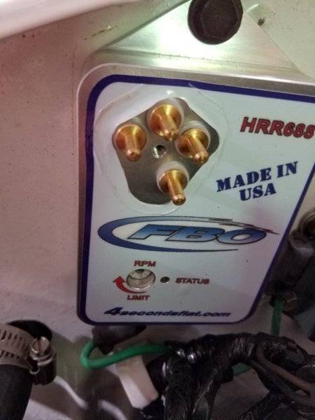

Shout out to FBO Systems for a very good spark in a stock looking box.

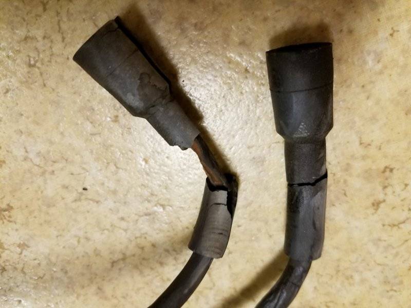

It was throwing almost 1/2 inch to the manifold.
Wonderful product.

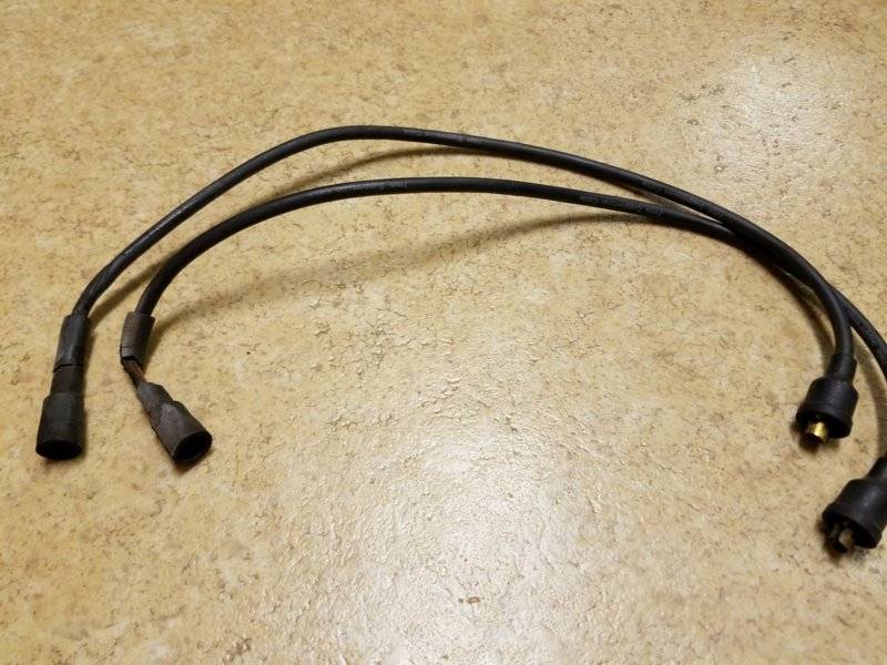

Car really gave me no indication of a problem till the wires let go.
(I've been busy and this car has been neglected. What can I say.)
