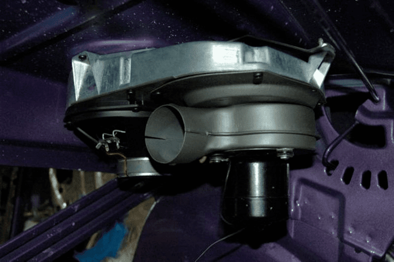

That odd looking opening was for a optional rear window defogger. I don't recall 4 speaker stereo systems in 1969, so no provisions were made by Chrysler.

defogger vent went in slot.
blower motor for defogger went in 5x8 hole.
optional rear speaker went in 6x9 hole.
The hole on the drivers side is for both a speaker and defroster fan. Doesn't seem very practical to draw air in through the speaker.

The standard rear speaker back then was a 5x7 on the drivers side. The 6x9 opening on the passenger side was for the rear defogger fan assembly.
