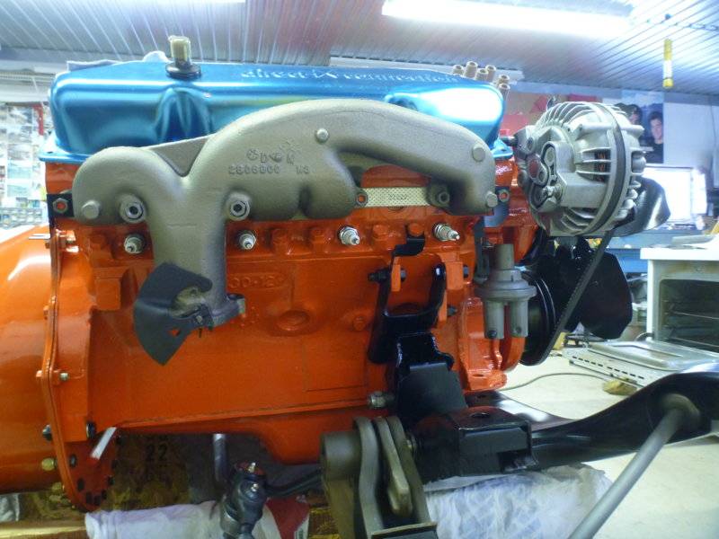

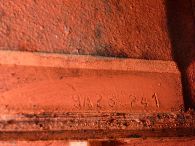

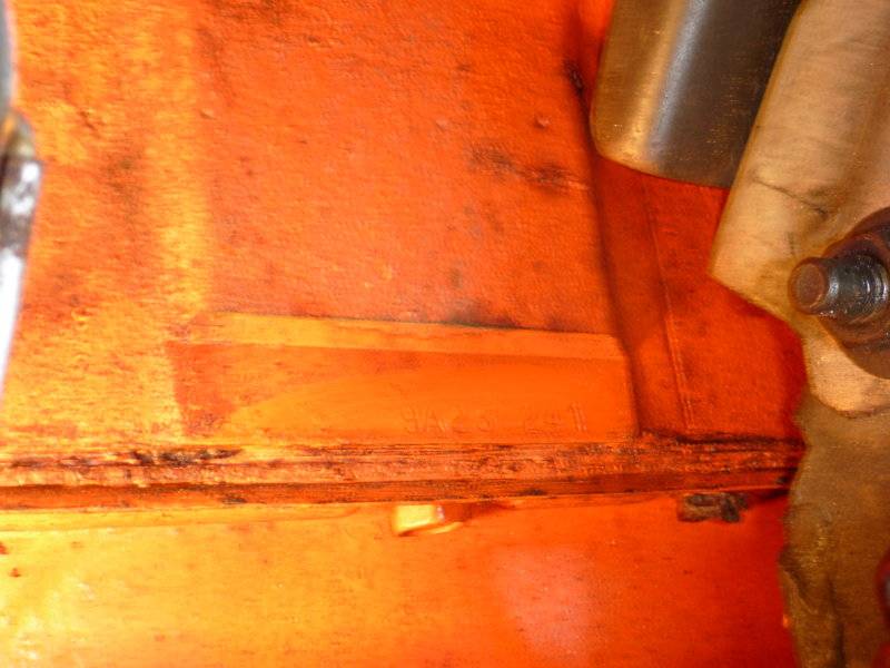

yea nothing there, i scraped off paint
scraped paint in 3 different places nothing
Then it's not the original motor if you're certain the pad is blank. If it's blank and still has the correct milling cutter pattern in it (and someone didn't grind it smooth) then it would be a warrantee block.

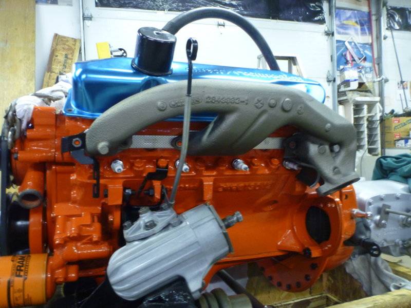

like i said, its entirely possible that the engine was replaced before it even made it to the dealer to be sold. Would not be the first time that's came up. So while niether the original owner or your buddy replaced the engine, it still could have been replaced. Regardless, you can't say its numbers matching unless the vin actually is stamped and matches. Now, if i were you, i'd pulled the manifold and get pictures of the casting numbers, especially the date code. At least you'd be able to say the block is DATE code correct IF it is.
Stick your head in there.. no reason you can't read the casting number on either side. Passenger is partially hidden behind head pipe connection, but drivers side is not.
