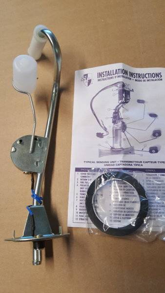

I used Quanta but where is it made? Instructions has SPI logo. Also has French language (Canada)
