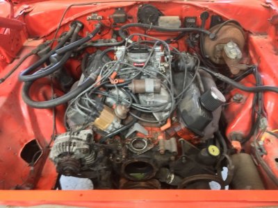

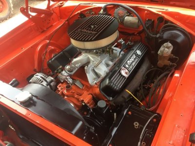

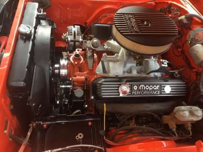

first of all, I'm not a big fan of non stock radiators or aluminum ones BUT my buddy has a dukes clone that's kind of a "driver" and he wanted to just make it nicer on a budget.
The stock radiator was shot. The motor had been rebuilt 10 years ago with little use but it was grimey from poorly installed gaskets etc.
So ordered the 26 inch two row (one inch each row) aluminum job that accepts a shroud and is for b body big block with passenger side upper inlet and driver side lower outlet.
For any of you considering it for the money it can't be beat and it sure as hell is better than a 40 year old stock one. It also made a non driveable car driveable for 250 delivered.
You will have to trim the outside edge if the passenger side that the stock shroud bolts to do it will clear the lip on the front end of the frame rail. Very little maybe 1/16 inch. Also slot the lower passenger side mount hole oval. Other than that it fell right in. Works great and on the cheap
Oh yeah and I painted the top semi gloss ceramic high temp black then shot with high temp satin clear (vht)

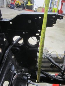

Anyone have any tips for installing a 26” in a 22” opening?

I took an air saw and opened it up.......Measure twice and cut it right the 1st time.

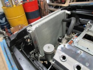

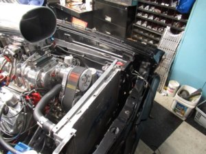

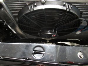

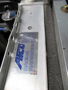

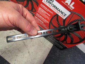

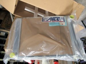

I am not concerned with stock looking.Bought an afco triple pass,2 row with 1 inch tubes.I also now only use one Spal 16 inch 2 speed pusher fan with no shroud.On pump gas I have about 850 HP and it runs 160*,,,,180* when it's 90* outside! It was $200 for the rad & $135 for the Spal fan.I really like the mounting set up on the Spal fan!!!!Real easy.
4.24.17 023.jpg 5.30.17 008.jpg 8.25.17 012.jpg 8.26.17 012.jpg 8.26.17 014.jpg 10.9.17 019.jpg 10.15.17 001.jpg 10.15.17 002.jpg 10.30.17 005.jpg
View attachment 566983 View attachment 566984 View attachment 566985 View attachment 566986 View attachment 566987 View attachment 566988 View attachment 566989 View attachment 566990 View attachment 566992
Damn those are some impressive temp numbers for that beast
With the old junk yard soursed dual fans,had to use a cigarette to see the air movement through the fan,now it blows so hard the air moves right to waterpump!
At the track with 1000 + hp it stays cool!
