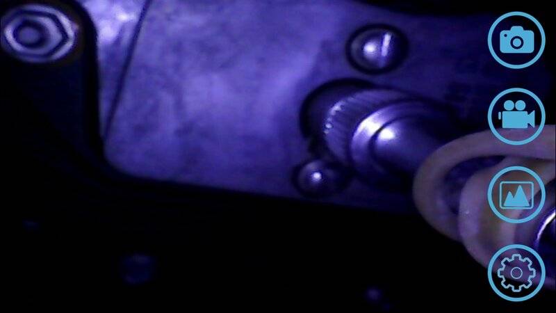

I got the cable installed at the speedo end with some help from my handy borescope and patience .
