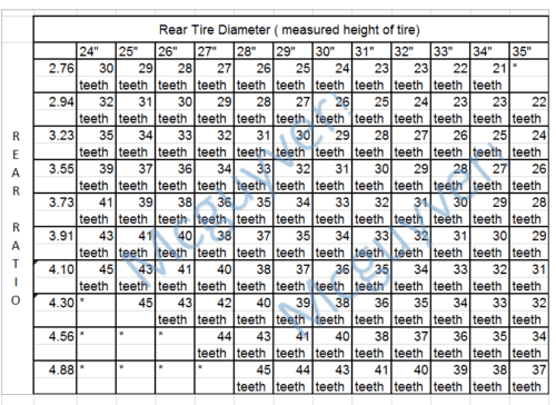

find the speedo gear chart on the internet and start there. john cope at cope racing trans has the formula on his web site and there is a chart on fabo under speedo gears for sale.
You need to use a calculator to determine the correct size speedometer drive gear for you tire size and rear ratio.
Online calculator.....this is one of many available online - there are dozens of them
Speedometer Gear Calculator"
Tire size needs to be 'height/diameter in inches'.

Sounds like someone ran a 45 tooth with 4.10:1 gears and now you have 3.23 or 3.54 gears.

As a follow up, I did the garage verification method to try to determine gear ratio. I am pretty certain that it has the factory correct 3.55. Not that it makes any difference, but the rear end housing does have the 3.55 tag and the metal "tag" for Sure Grip on the outside of the housing.
