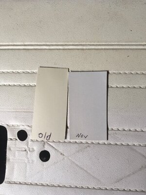

So bottom line, I had to match the rest of my interior to my new seat covers. I was told to hit up Kolor Korrect. Jaime (Who is super awesome by the way) explained to me that around 2018, legendary changed the dye for some of their seats, she sent me color samples of the old and new colors (see pic). Well as it turns out, the old formula perfectly matched the old faded/yellowed interior. The new formula is a very close match to the original color, as compared to the original unfaded area under the armrests.

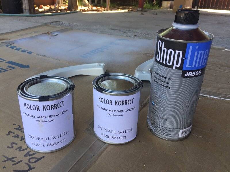

So I ordered the new 202 pearl white formula. The color is actually two parts, a white base, and a pearl. I bought a pint of each, and a can of reducer. The paint gets mixed with the reducer on a one to one ratio just before spraying.

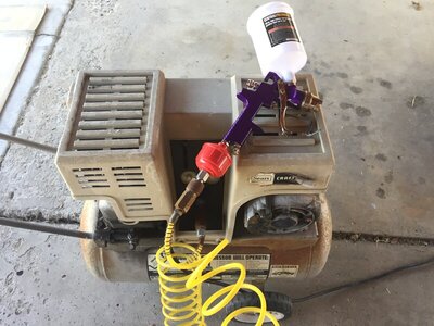

Per their instructions, I purchased some Bulldog Adhesion Promoter locally. Also, purchased a cheap paint gun and filter from Harbor Freight.

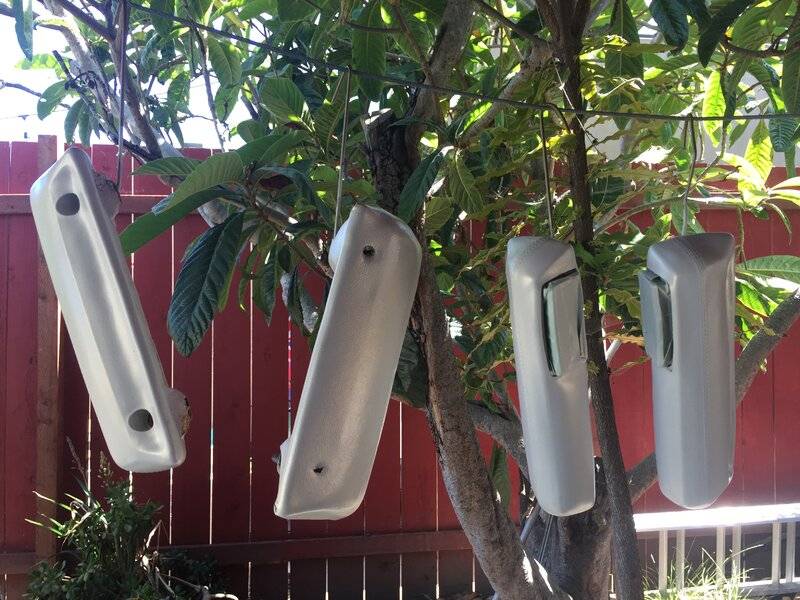

I pretty much followed their instructions to the letter. Step one is cleaning the parts. Step two is spraying the Bulldog Adhesion Promoter. Then the final steps are hitting the parts with a couple light coats of base, and then a couple light coats of the pearl.

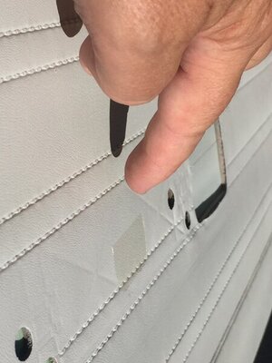

Below in the picture you can see my finger pointing to a little spot that I covered with tape to compare the new paint to the original unfaded color, it’s pretty damn close.

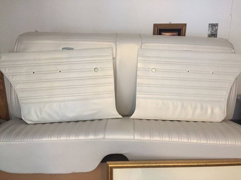

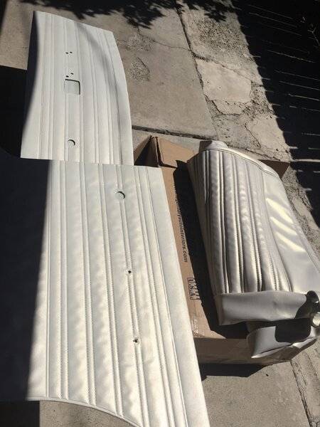

Despite my fumbling with the cheap HF gun, I am very impressed with the initial results. I recommend anybody thinking about this to go ahead do it yourself. And of course thanks to Kolor Korrect.

Did they sell you the JR506? Any other labels other than other than the huge ones they covered the can with? I’m curious what Shopline product they used?
That's PPG Shop Line. I have a can of the HR 506 in my paint cabinet.
Nice job on the door cards!
They recommend using PPG DTL-876, or the shopline JR 506 as a substitute. I decided to buy at the shopline directly from them, just in case I couldn’t get the PPG stuff here in commiefornia.
I’m with you just one the reducer. I want to know what product is in the other cans.

Love that purple harbor fright gun. Those things are great
