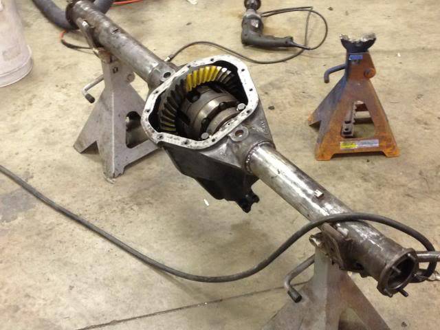

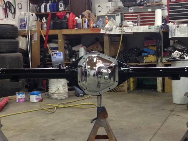

Been a while since i started a thread. what does every imitation A12 need? a Dana 60. scored one out of a 68 charger last fall. original 3.54 gear, pretty unmolested except for a set of green bearings. Took it apart, welded the tubes, put all new bearings in it along with a used but factory 4.10 gear. it was time for an upgrade, the 8.75 housing had seen better days, seems to be a little twisted or bent. plus it was twisting the splines on the left hand axle again. Dana should hold in there a little better.
Thats nice ! I want to put a Dana in my 63 one day when I get the money. So far the 8-3/4 is holding up for me. Ron
