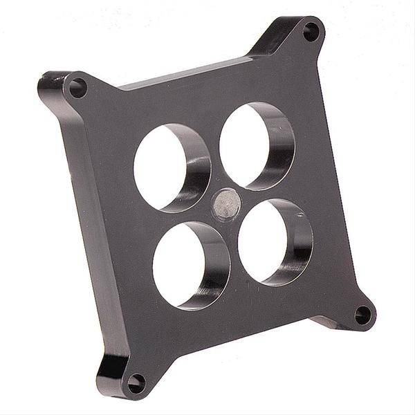

Have you tried a non-metallic carb spacer. Ryertex not sure I spelled it correct? KD help:rolleyes:.
Phenolic spacer
-1
Phenolic spacer
-1
Already have one. Along with an aluminum ‘wall’ mounted underneath the spacer. Also have a vapor return line, that’s the old school fuel filter with the 1/4” return for vapor all the way to the fuel tank
