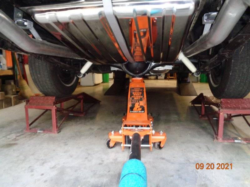

I put a stainless tank in my 64 Fury. I had issues with rust in the original tank due to darn ethanol gas. Hope the stainless never rusts, and I hope I can continue to find, and afford, non-eth for it..

My tank came from "Tom's Classics", an ebay seller. No complaint with it. The filler tube seal came from Inline Tubes Co. as the original no name seal from ebay didn't fit properly. And I did reuse the sender lock ring instead of the new one, because I had trouble with a different one on another car in the past. The metal was a bit thinner than the original, and it allowed the fuel to leak.
