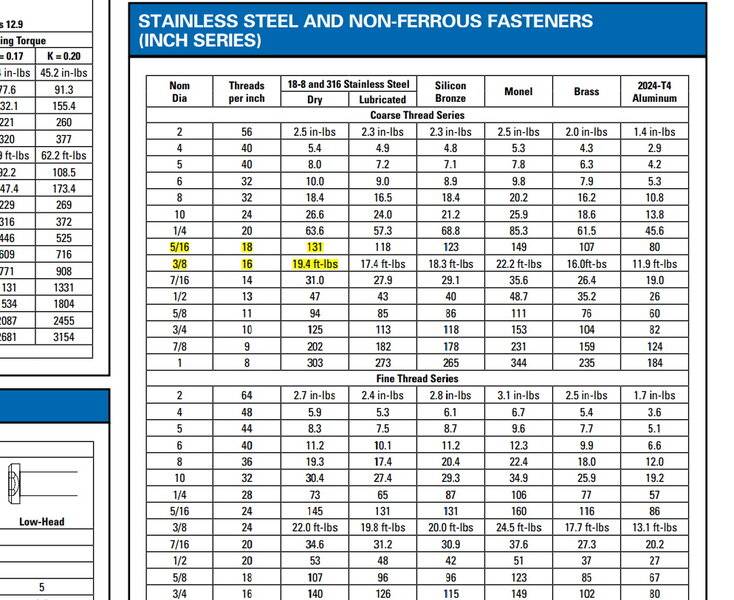

Well, there is the load from being torqued to the proper spec, so that needs to be taken into account.

The issue isn't rust, its galling - which stainless likes to do. If you Google it you can probably find torque limits for stainless bolts. Keep in mind that stainless bolts are used exclusively in the food industry in all sorts of machinery. You wouldn't want to use them on your connecting rods or crank but they can be used just about anywhere else. One downside to stainless ... loctite doesn't work very well on them .

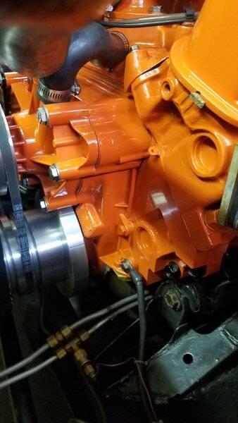

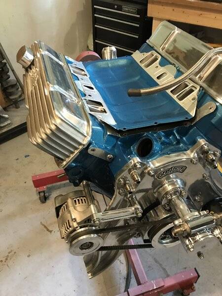

As pointed out, stainless is prone to "galling" so anti-seize should be used. Here is my boat's engine. Everything is ARP stainless except for the main studs, damper bolt and flywheel bolts which are ARP chromoly.
Don't use the crap from retail stores.
I live near this outfit :https://www.fastener-warehouse.com/ The have everything and supply the Portsmouth Naval Shipyard (sub base)
If they are ARP, I'm sure they are matched to the application.

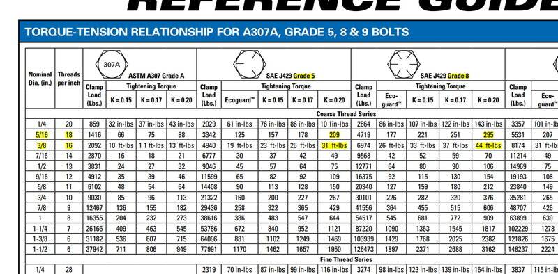

Not being hard is a myth. Stainless bolts will have a Rockwell core hardness hardness in the C32 range. By comparison a standard grade 5 is in the C34 range and grade 8 in the C33-39 range. The real difference is in the yield strength with stainless being about half that of a grade 8.
Where stainless is widely used, the sizes of the fasteners would be enlarged to compensate for the difference in strength.

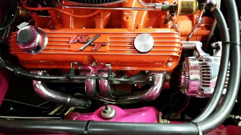

My race motor and both my street cars have stainless water pump, intake, valve cove, timing chain, and header bolts. The race car is the newest build, 10years old. The street cars are 17 and 30 years. They have not corroded, broke or galled. Both street cars have iron heads.
