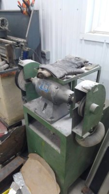

Spend the money, get a Baldor and don't look back. Mine is a 1.5HP model and it generates 3500RPM. You need some speed to do stainless. A variable control would be nice if you are just starting out so you can get a feel for the work. And yes, be careful, you need your head in the game when you are buffing or bad things will happen. Wear a respirator as the silicate will do nasty things to your respiratory system. Have fun!

I have a 3/4hp Baldor and it will make a pretzel out of anything you want. LOL Can't imagine what a 1.5hp will do.
