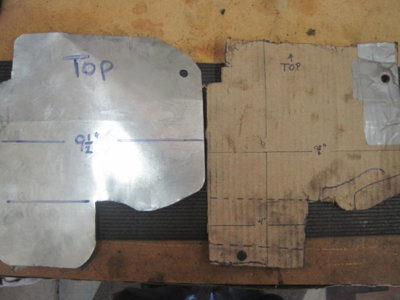

Currently using a DEI starter blanket but a lot of guys believe it could be causing heat soak rather than preventing it. So I'm fabbing up a starter heat shield from 26 ga mild steel. I started with the cardboard template and transferred it to the metal. The hole in the upper right runs a bolt that screws into an unused threaded hole in the bellhousing adjacent to the starter (possibly abandoned when converted from factory bell crank to Lokar kickdown cable). The lower left flap needs a 90* bend to go underneath the starter.
The problem is that the mild steel isn't as pliable as the cardboard and there is no room between the headers, trans cooler lines, starter, etc.

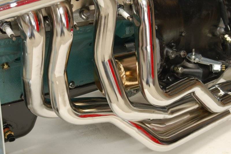

Another way that I have seen to put on a heat shield. Put a muffler clamp on a header tube near the starter, and then use the threads on the clamp to mount a shield.

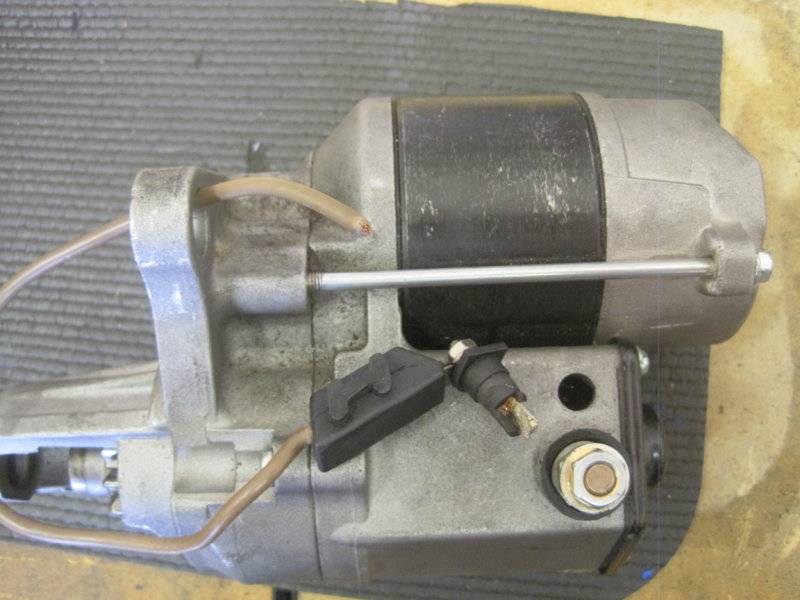

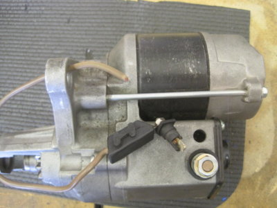

Swapped in the Mancini starter yesterday. Taking out the old one, starting loosening the solenoid wire and this happened...
the stud pulled out of the starter. To everyone here that said it was the starter, you were right.
While I was at it I replaced the OEM 12 ga wire with 10ga (even found brown insulated to match the original) and wrapped it in heat shield sleeve. Routed both the wire and the 1/0 cable back parallel to the block and then up the firewall.
