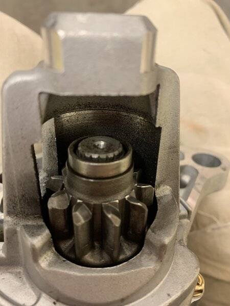

Mini starter and no clearance issues at all this same starter cranked my 440 for 5 years and never had one problem. It looks like a new one and the gear looks good with no noticeable wear but it just seems like the solenoid isn’t pushing the gear into mesh when the ring gear isn’t lined up just right and I never acted up the first time I had this engine on the stand.

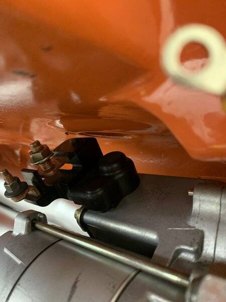

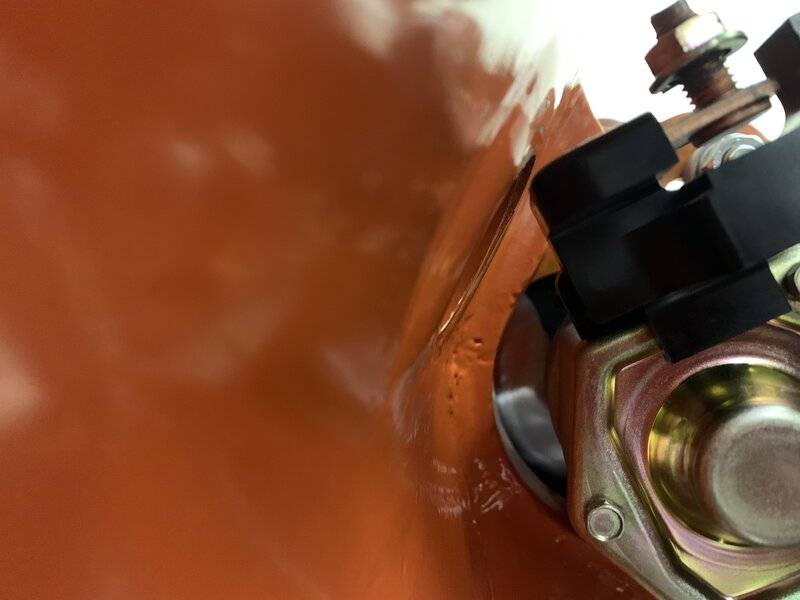

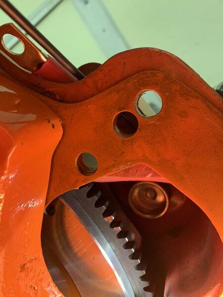

I don’t see any interference between the starter and block. Here’s a few pics that may help
I think i figured it out. there’s some side to side play in the starter and the opening so I moved the starter outboard as much as possible and so far it hasn’t acted up.

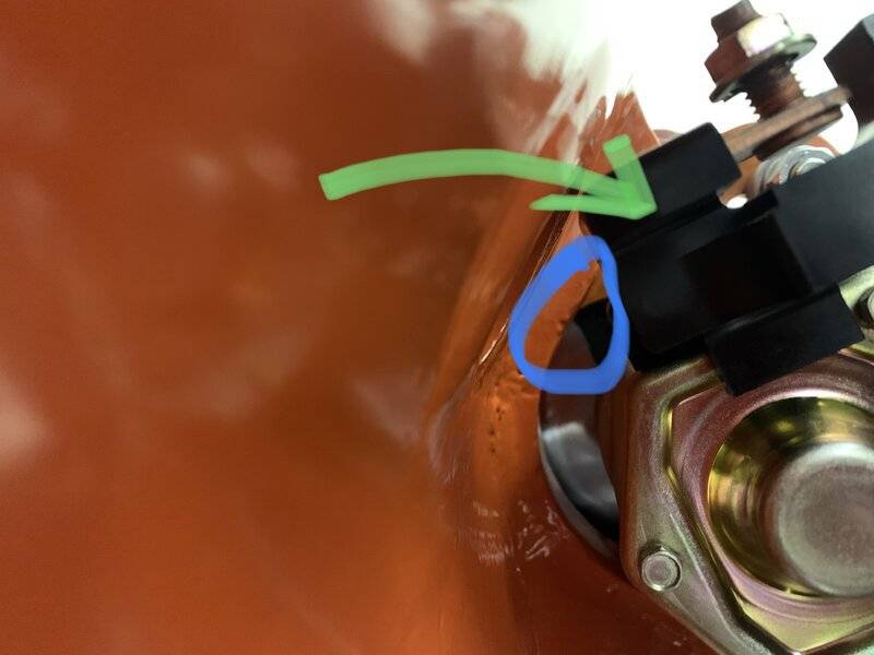

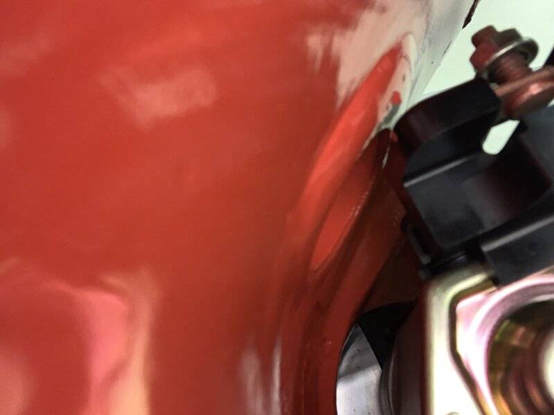

The area I had clearance issues was on the block. Circled in blue. I have a low deck 400 though so maybe they are different.
Also you can remove the plastic piece that the green arrow points too if you want. That’s gets the cables further way
