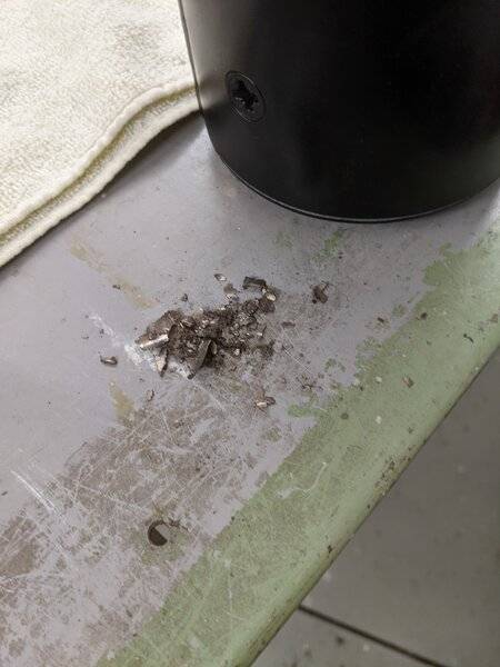

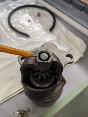

Took my starter because this summer it was spinning freely once in a while. What I found is the nose bushing completely disintegrated. This starter was restored 5 yrs ago. Any ideas on what would cause this. Starter bolts/nut was tight when removed. Pic is the metal found in the cup in the bellhousing cavity and of the starter.

See if the started drive gear is bent. Had that once a loooong time ago.

I was in contact today with the firm who rebuilt it 5 yrs ago, they offered to fix it for me, that was unexpected and I wasn't asking, so after the holidays I will send it to them. They did not offer any obvious reasons, they did mention the nose might not be usable anymore and the bendix is probably bent.
