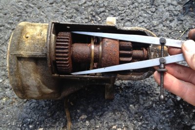

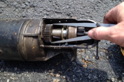

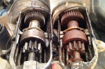

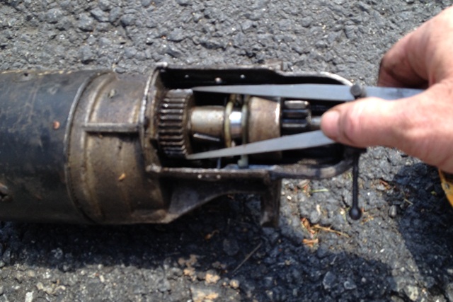

There is not really a way to tell from the outside. Mopar made different 'strength' starters for heavy duty and other applications. These will look slightly different on the outside (HD ones are typically longer). What you would need to do to ID the gear ratio is to snap the cover off the gearset (bendix) and visually inspect.
Basically the 2:1 gearset (on left) is smaller than the 3:1 gearset (on right).
The 3:1 Bendix gear is approximately 2" in dia.
The 2:1 bendix gear is approximatley 1.75" in dia.

And apparently the 3:1 uses some sort of brown metal. :) But seriously, I wasn't aware of this. Do they pull different cranking amps?

You like that? I think it's called 'patina'. I was in a hurry so I just grabbed some, er..'seasoned' parts for the pics.
The starters came in different amp ratings based on application.
