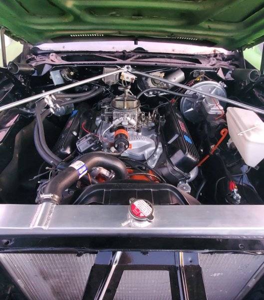

Hi guys, hoping to hear from all the experts here.
I finished building a 440 for my 73 Charger, removing the 400 that previously died.
I have a 67 GTX Block, with 915 Heads, a Comp 268H cam, steel crank, vintage Hooker headers, Holly 750cfm Carb...
I drove the new engine 3 or 4 times after I built it, but the carb was running funny. I rebuilt the carb, and on my very lean, initial start up of the engine the muffler exploded. It turns out the muffler shop I took the car to had a piece of slag remaining inside the exhaust pipe, and it blocked the muffler baffle and when the engine started up, backfire ignited the gasses and it blew. I found the half dollar piece of welding slag 5 feet away embedded in one of the plastic engine covers on my motorcycle, lol.
While waiting for a new muffler, I replaced the rear differential gears with larger gears and a sure grip. When the new muffler came I only replaced the blown one, since it was similar enough to the old muffler to not make much of a difference.
The issue I'm having now is the engine won't turn over. I tried 2 different coils, another carburetor i had, 3 different distributors, ( 2 points and 1 hei style), and 3 ignition boxes( chrome and orange).
I had a viper alarm installed, which I disconnected. I wondered if that could be killing the ignition boxes and that was what was causing my errors. Doesn't seem to have been the case.
I have spark, I have gas, I have timing dialed in at TDC.
The only possible things I'm seeing are that the distributor doesn't seem to be fitting flush with the engine block, it seems to be raised maybe a 16th of an inch off the block. I checked the intermediate gear and it seemed to be fully seated, with one caveat, it looks like there was a very tiny chip taken out of the brass gear. I'll be trying out a new intermediate gear this afternoon, but I'm not feeling that's the issue since the car ran before. I dont recall if the distributor seated fully initially or if that's a new issue. The intermediate gear seems to be aligning with the cam gear, so I don't know if it's raised due to the oil pump height or what.
Could my engine need higher octane gas, and that's why it's not starting? I'm in California, so I've only got access to 91 unless I go to a gas station near a race track or add octane booster myself.
My mechanic friend is suggesting a leakdown test, but I think the car would still turn over if there was a exhaust/intake leak, right?
I'm stumped. Any help or suggestions are welcomed.

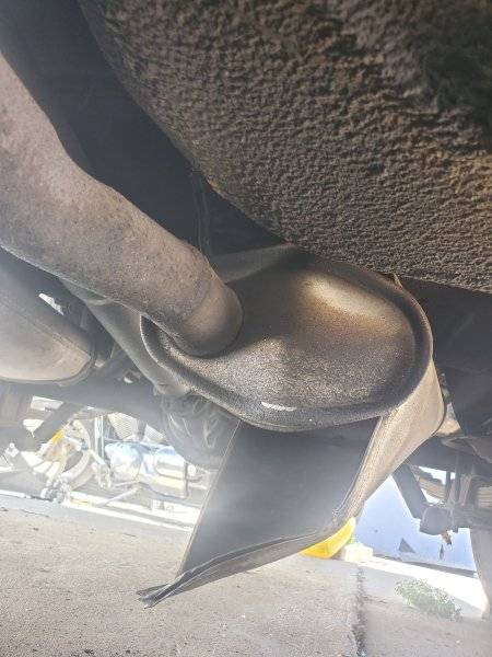

Here's the muffler, and you can see the motorcycle behind it, lol. I don't have a picture of the slag, it was nickle size and had a smooth curve in it, the same angle as the inside of my pipes.
You can bet that explosion in the exhaust is from the issue you have going on now. No way in hell would a piece of old cold slag cause that. You has a lot of un-burned fuel in the exhaust and the ignition lit it off. To your problem. Start with getting number 1 on TDC compression stroke and see where the rotor is pointing.
