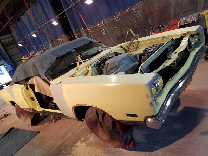

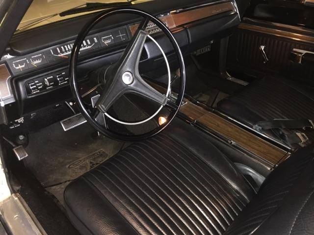

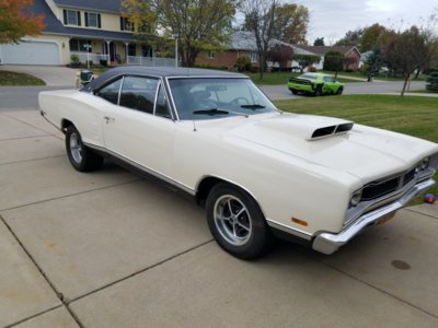

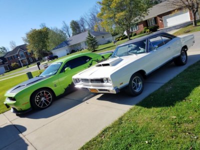

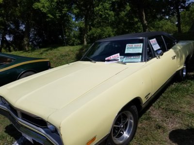

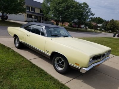

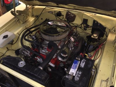

Hi all! New to the hobby and even newer to the forum. I've owned a couple late model Challengers and a couple years ago started really getting into the older cars. Mostly 68-70 B Bodies. Last year I pulled the trigger on a 69 Coronet 500 318 manual car I found in Canada and paid $15,500 USD for it. The car was in great shape. Recently restored. Body in great shape, no rust, new interior, engine rebuilt a few years back, runs and drives really nice. Mostly a "survivor" with some OEM replacements.
My plan is to make a restomod/pro tourer out of her that's mainly for the streets but capable of the occasional trip to the strip or road race or really whatever I can find that she can do. Not dedicated to either and built for the street first and foremost, but something that won't be a slouch wherever we may roam. At the end of the day I want something fast, capable and sexy!!!
I'm doing this for a few reasons. 1) I want something truly unique and in my opinion these are the most beautiful cars in existence today. Modern cars just don't have the same appeal to me. 2) I want to learn. I've always had an interest in cars and can't do much right now outside of changing brake pads. I have a friend who knows his way around cars and he offered to help so I want to get my hands dirty and do as much work as I can. Really build something. Hopefully a lot of somethings from this point on. 3) I want to have something to bring to the car shows. We go to Carlisle every year along with a bunch of local (WNY area) shows and plan to go travel to more this year. I'd like to not only have something to add, but be able to enjoy other's cars more by actually knowing what I'm looking at.

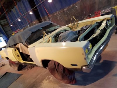

My plan is to mechanically upgrade pretty much everything as well as give a little love to the appearance. I want it to truly be a 1 of 1 when I'm done. Not looking to clone an R/T or a Bee or put it back exactly as I found her. I plan to put some custom badging, striping, interior, wheels, etc to really make it mine. Here's what's been done so far as well as a list of my plans for the future and some pics. Please, if you have any help you can offer, I'm all ears! The guy I'm working with is not a Mopar guy. Mostly worked on Chevy's and Fords and I'm just reading as much as I can to prepare but we're gonna figure this thing out one way or another.
I'll update my costs as I go as well.

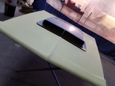

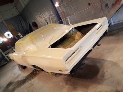

- Paint changed to white, scoop added to hood and body filled as needed ($3500)
- Hood scoop ($177)

-NA 440 in the neighborhood of 600 horse with ability to add Nitrous later BUT FIRST...

Nice car.
Welcome
I like the taillights on 68&69 Coronets
Agreed, leave the rear panel alone. Distinctive to 500's and R/T's. 500 badging is sweet. Nice ride. Biased, but the 69 B Body is a beautiful Brute.
Nice car. I think the 500 trim and badges look pretty good on these cars. I like the rear tail panel, but maybe convert the center reflector into an actual third brake light (LED?)
