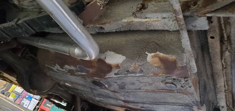

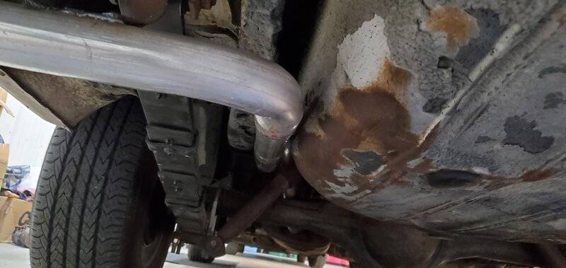

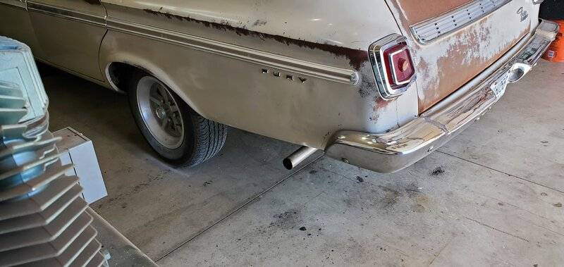

      The factory brackets were still in place then I installed this pipe.
      • Like Like x 1

        out the rear side.

          Love that car! I have been looking at photos on the net for a good example. I sure don't like the exhaust to blow down towards the ground. It stirs up a lot of dust (for your car and others) What does the the underside behind the rear axle look like? Is there a foot well for the rear seat? Room for tail pipes?

          I dont have a third seat. The foot well is behind the spare tire. Spare stay in place and feet find room around and behind it. As you can is in picture ,plenty of room for the pipes.
          • Like Like x 1

                  Came out as posted but don't think at a 90* angle more 60*s and end of pipe was cut at an angle.
